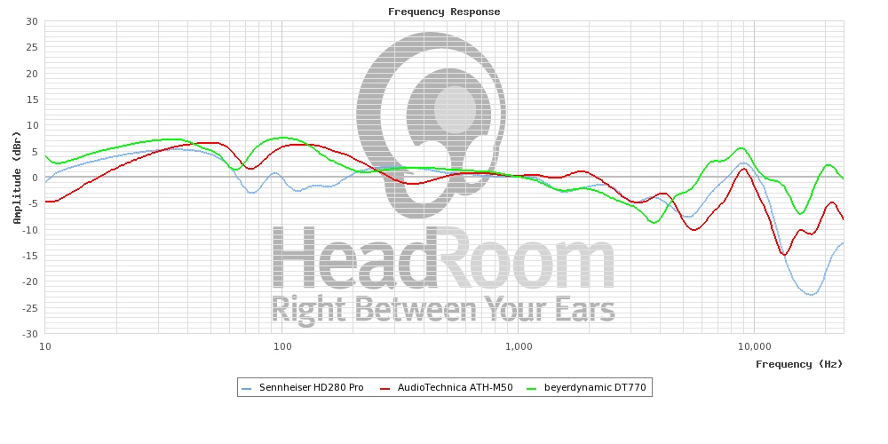

Digging deeper, it’s also interesting to note, that many headphones designed for accurate studio monitoring also incorporate a LF shelf similar to room gain. Three examples here

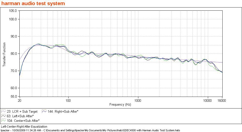

Interesting!
Check me to make sure I have this straight:
Harman Audio's research is saying that the ideal (as in most preferred) in-room FR would have an 85dB shelf from around 30Hz to 60Hz which would taper down to 80dB at ~150Hz to ~500Hz and then gradually taper down to 75dB at 16000Hz.
I have some questions if the Harman write-up addresses them:
Did they discuss the low end roll-off? Their ideal curve rolls off from around 85dB at 30Hz, down to 77dB at 20Hz. Is this part of their researched FR or does it reflect equipment limitations?
Do you know what content was used for the study...was it music, or movies, etc.?

A shelf, as referred to in a FR graph, would be an interval where the response is essentially flat, but generally above or below the nominal SPL.
If you look at the faded gray line below, there is a +5dB shelf from around 30-70Hz.
