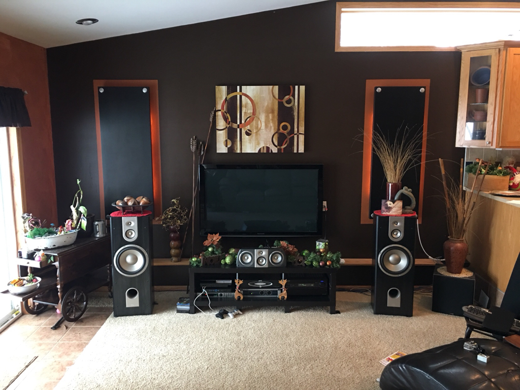

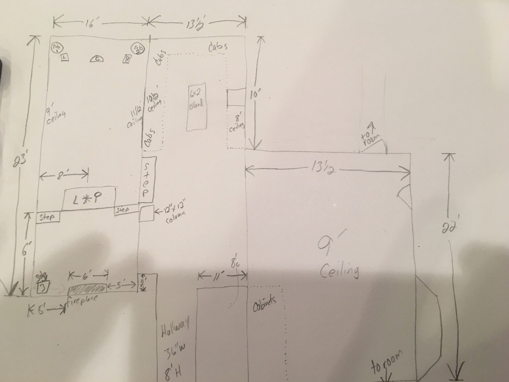

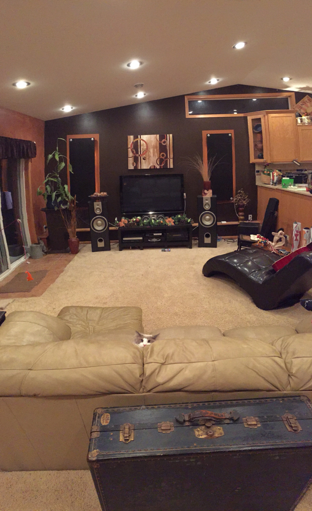

Ok. So per @TheWarrior requesting room dimensions to calculate room modes and then what to do with them, here are mine. The proportions aren’t exact but the measurements are. Hope the picture is clear enough to see my scribbles. I can color it or highlight it if necessary. Also, here are some pics of the spaces to help fill in the gaps that I can’t provide in the sketch. They are of my house in different states of living and remodeling etc, so some aren’t flattering. Kids... lol
Also, the PC’s are in the front corners and the 3rd is in the left rear by the fireplace. So keep that in mind. Mains are 14-1/2 from LP, front subs are 16’ and the rear sub is 9’ away. I tried posting my mdat so anyone can look at any measurements I’ve made. I’ve swept with each sub individually and together, and w/mains and Direct. File is too big, trying to figure it out. Mdat is easier than uploading all the dumb screen caps. Ok, 1,2,3, go!
Need anything else? Just ask.

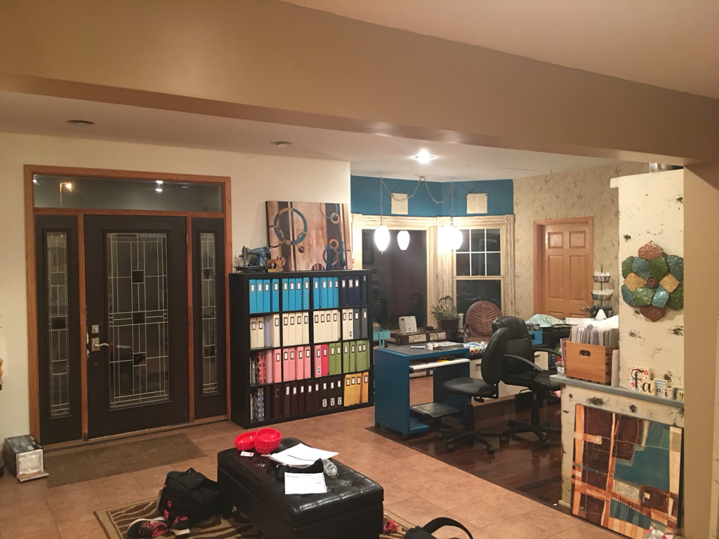

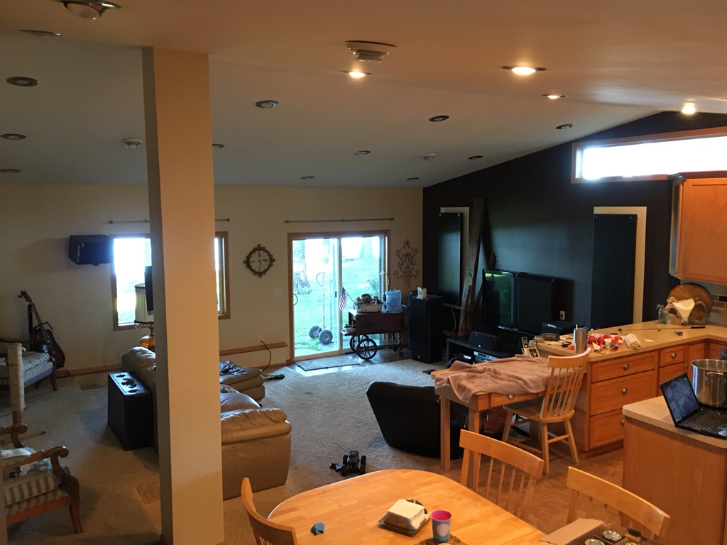

It looks like the right side of the living room opens to the kitchen? That can totally nullify any cookie cutter calculations.
Also might want to spread the fronts out more. Should be 22-30 degrees. Hard to tell without a measurement but it looks like you’re what, 12’ from the speakers? Should be 10’-12’ apart if that’s possible.

Yep, the LR does open to the kitchen foyer a hallway and two other rooms. The pic with the mains you’re referring to is old, and just to give a feel for size and airspace. The mains are actually centered at 10’ currently. 14-1/2’ from LP.

Length:
22'= 51 hz
23'= 49 hz
32'= 35 hz
Width:
29.5'= 38 hz
42.5'= 26 hz
Height
9'= 125 hz
11.5'= 98 hz
Two things first: I love your room and the stealth guard kitteh!
Mitchibo PM'd me a subs only response graph - my thoughts:
First: the pics and the map don't line up in regards to your sub locations.
Discrepancy centered @ 35 hz = two modes stacking on each other. The dip at 32 hz is the length mode that your rear subs (are there two in the rear?) should be able to handle. The dip at 37 hz may reduce after first filter is applied.
Steady rise from 37 hz to 46 hz= mode between your seated front and rear boundaries. Need to reduce amplitude of this mode, need to know where your subs are located in the measurement you sent.
The graph peaks @ 46 hz and then rolls off from there.

Ok. I’ll need a little time. Thanks for the nice words. That’s my killer cat Sully. Biggest baby in the world. Perhaps I wasn’t clear enough. The map locations are correct for subs with the pictures to fill in the blanks and show ceiling slope, and sunken LR etc. So, two subs in front corners, one sub in rear left corner. Distances in first post. I’ll dig my gear out shortly.
