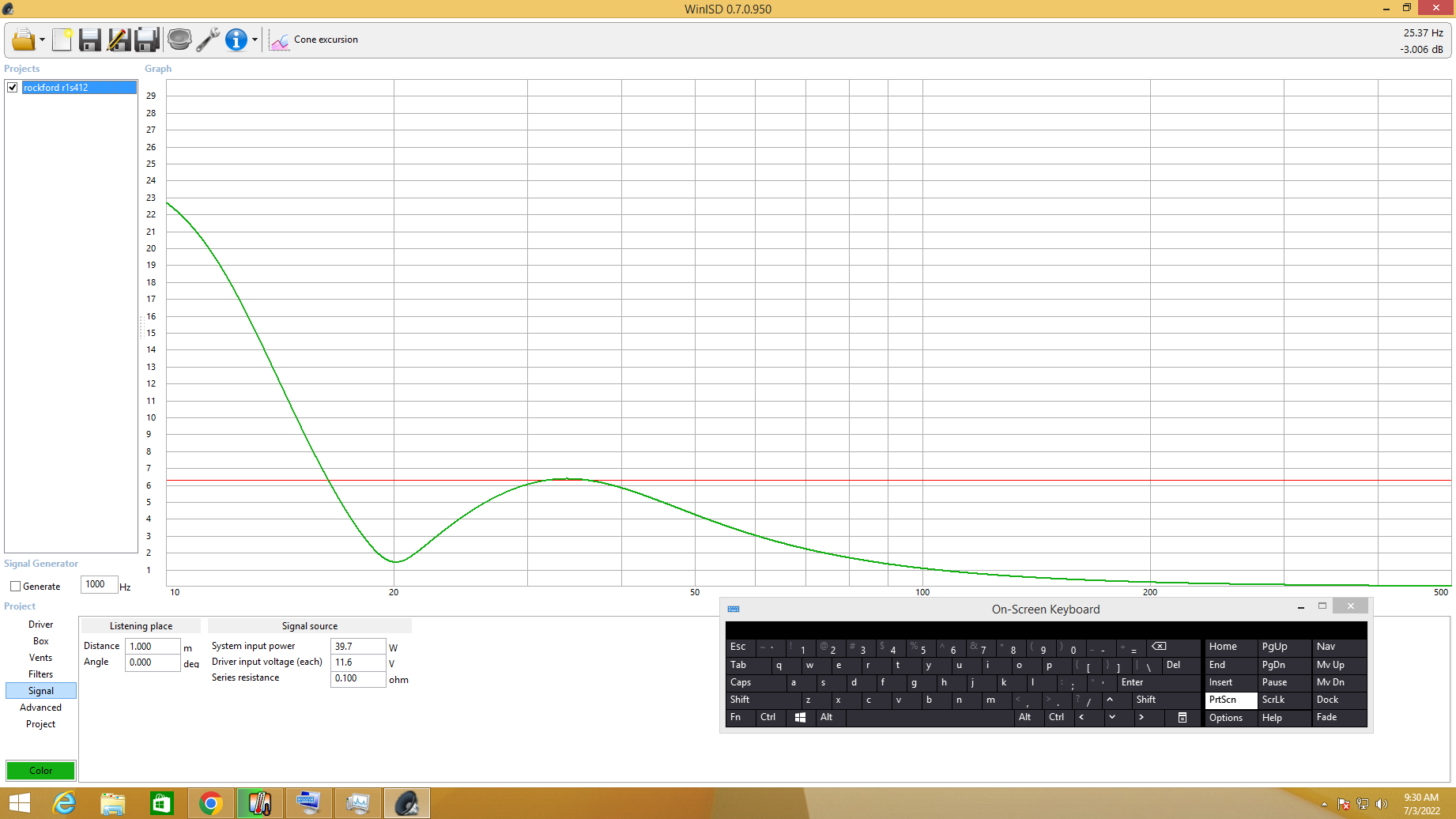

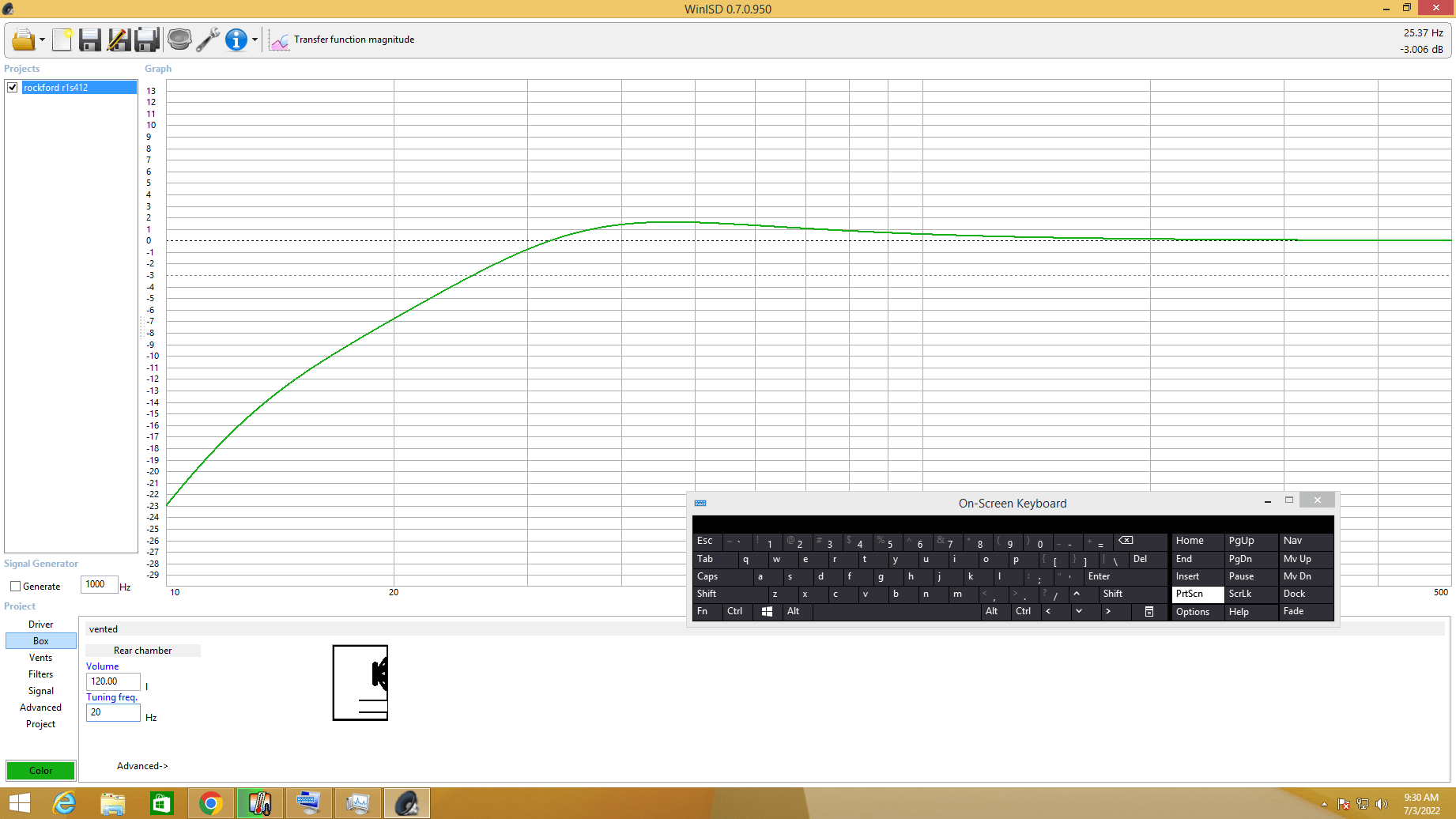

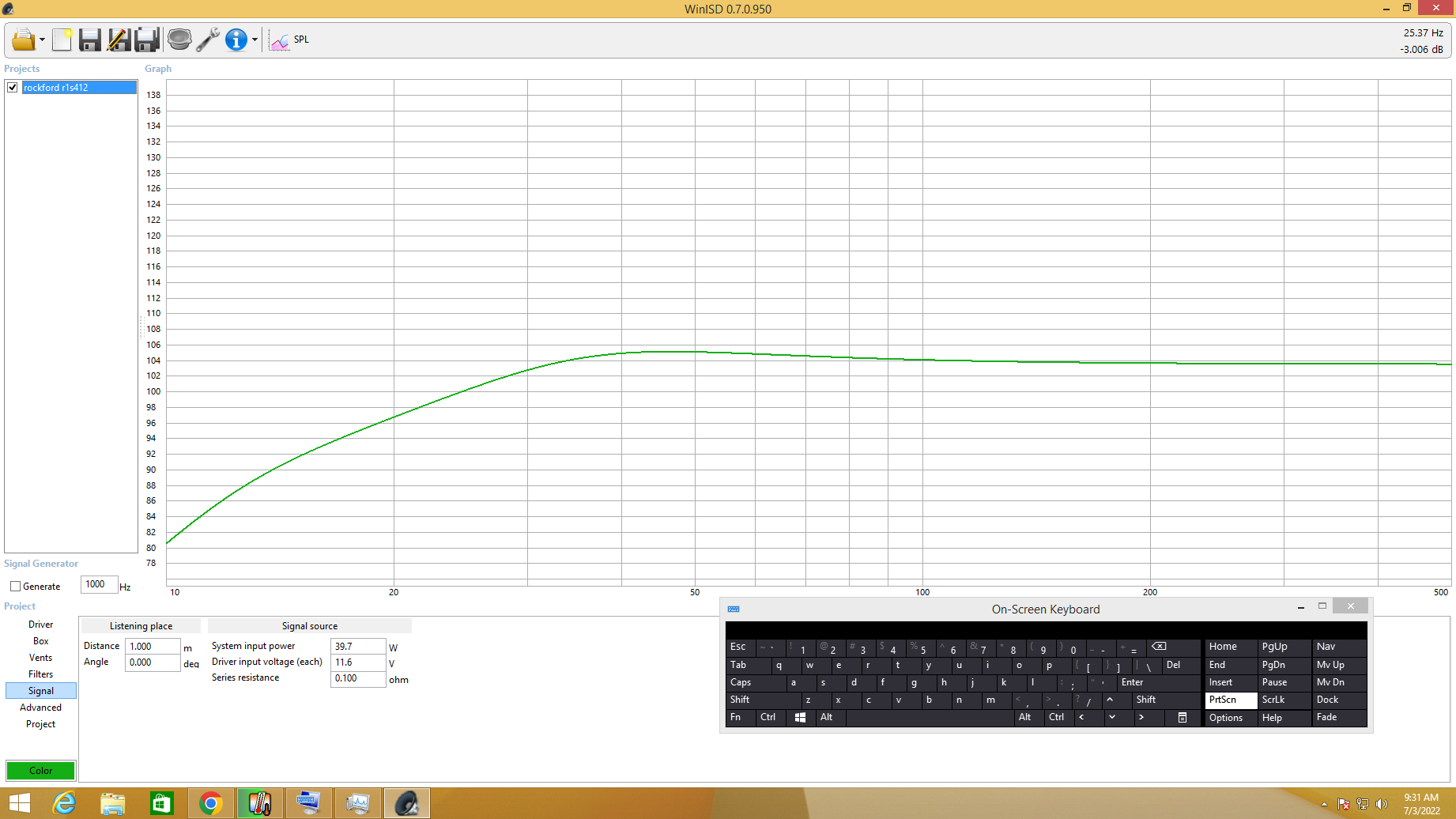

trying to figure out enclosure size reports shows it hits 20 hz in good db levels by many users---
search rockford r1s412 in amazon
i just need 20 hz at good db level subwoofer
i would prefer a enclosure around 70-90 litres but not getting proper results in winisd if tuned to 20 hz or 30 hz
i dont like 70 hz bass boom boom type only 20 hz to 40 hz what can be felt only
specifications-
-----please help me enclosure size and aeroport size length and diameter

IMO, winisd is providing you with the exact appropriate enclosure size for your driver. The laws of physics are inflexible.

As I already told you, the laws of physics are immuable. You will never get an acceptable output from your Rockford Fosgate in the whole 20 to 40 Hz range, because of its physical characteristics.
You will never get a 20 Hz response from any speaker in a 90 liter box. At this low frequency, you need a lot of air displacement, a bigger box and a driver which can dig that low. You have a lot to learn about the functioning of loudspeakers. I suggest that you verify on the Parts-Express site for a book on loudspeaker building:

That is a car driver. Although it has a low Fs, its cone excursion is limited. There is only limited data of the Thiel/Small parameters of that driver and so it can not be modelled. I suspect the the optimal sealed box quoted in the specs is optimal.
Now a sealed box always has a high F3, so Eq, at 12 db per octave has to be applied below F3, and then a high pass filter at xmax. That is a very cheap driver, with a poor motor system giving a very poor xmax. So that driver would not tolerate Eq. So you are essentially stuck with the box size the manufacturer recommends. In car it would probably perform reasonably, due to cab gain. For home HT this would be a very poor choice of driver.

What others have stated is generally correct. That woofer is not a good HT candidate for low frequencies. The Xmax is much too low for sub 40hz at higher output levels.
Try something like the Dayton RS series, the HF version. Quality motor with much more xmax.
