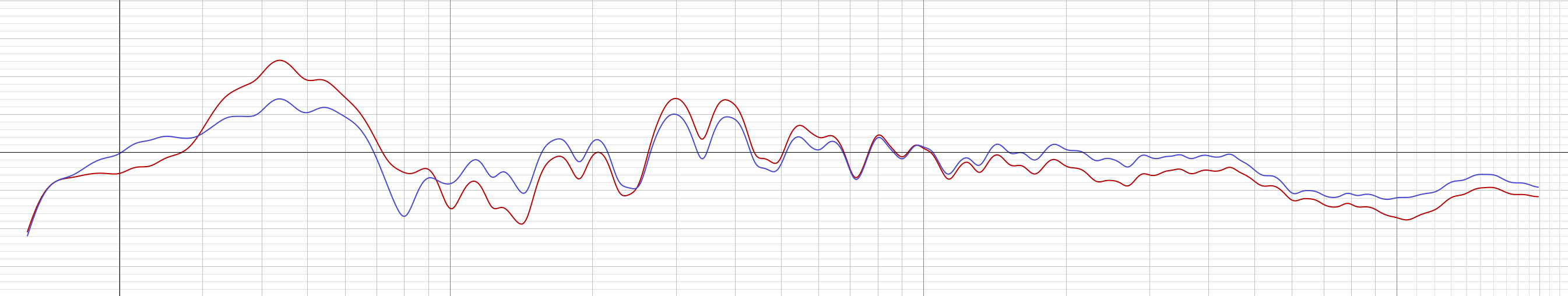

If you're looking for another set of REW measurements, this is the fronts (w/ sub) from my livingroom after the last ARC tuning:
The red trace is the raw measurement, the blue trace is post ARC processing. The "cross" marker is 20Hz at the 75db base the measurement was taken at.
The issue in the 70-150Hz zone are definitely room and placement related. Note that ARC actually made the 80Hz dip worse as it tamed the peak lower and tried to normalize the region just above. If I moved things around a bit, I could probably get some smoother results in that area but it's a living space and I'm content with them where they are.

Thanks, for that data, I don't see the axis numbers or the distortion levels. But I would be concerned about the big bass peak at the lower end, could be boomy. Especially coupled with the big dip proceeding. Hard to decipher, without defined axises.
I requested a 6db boost below 150 Hz for room gain. It's not being toned down more by design. It's a preference thing. The room issues happen to land within the upper range of that though, so it doesn't curve as broadly as the ideal would be. Again though, I have no issues with it in actual use/listening.
