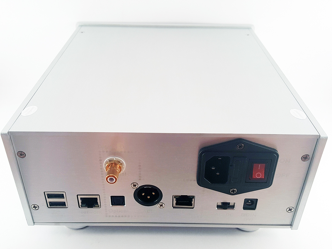

At the back panel are (from left to right):
  • 2 x USB ports
  • Network port
  • Coaxial out (top)
  • Optical out (bottom)
  • AES digital out
  • IIS PCM audio data out
  • AC in (220V) and power switch (top)
  • AC DC select switch and DC in (9V)

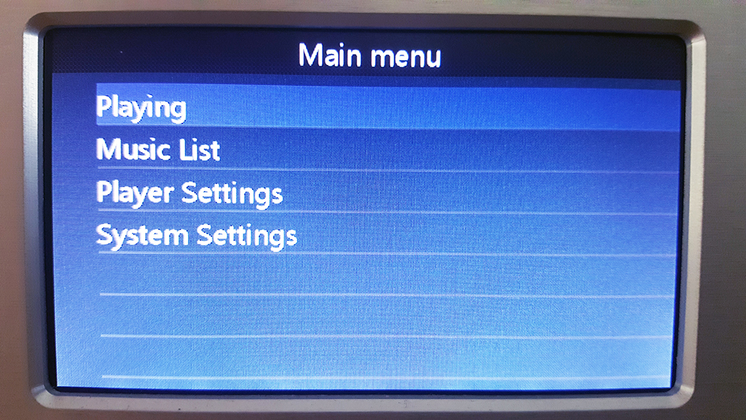

Using the D3S (with Firmware v0.25):
Operation of the D3S is a simple affair. To turn on the unit simply press the power button for 2 seconds and the same to power off. Upon startup we first see the Shinrico logo and then we're greeted with a welcome screen. Boot time is about 25-30 seconds. Now let's take a look at the menu settings.
1. “Main Menu”
  • Playing
  • music list
  • Play Settings
  • System Settings
3. “Play setting” interface
  • Play mode
  • Memory playing
  • Seamless playback
  • Update music database
  • directory player
  • DSD settings
2. “Play List” screen
  • All Tracks
  • folder
  • Album
  • Artists
  • my Favourite
4. “System Settings” screen
  • system information
  • Reset settings
  • language settings
  • backlight brightness
  • backlight time
  • IR Settings
*It's worthy to note that "Update music database" only works when using a SD card. According to the manufacturer the reason for this is that it's common for users to have 1-2 terabytes of files on USB devices (external hard drives etc) and automatic updating of the database is too slow.
The 4.3-inch LCD screen is crisp and clear with rich color. It stays completely cool to the touch even after hours of use (as does the unit itself). Navigation is simple using the remote or the buttons on the face of the unit and the UI is snappy and intuitive with no apparent input lag. Album art is supported and covers look vivid and clear with track and file information shown next to it on the right.
