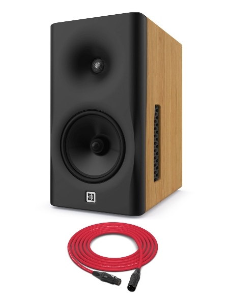

For the sort of money you're contemplating, your placement constraints, and the room size, I'd give some consideration to the Dutch & Dutch 8Cs:
About $13K with stands, but they're powered and you won't need the Parasound equipment, as you can stream directly to the speakers.
Here's a review with measurements of them:

I've heard good things about the D & D speakers, but having just bought the Parasound, I'm somewhat reluctant to start over again, and they are getting above my budget by a bit.

Since the Studio 2 and Salon 2 were introduced in 2007, people have been speculating about a 3-series for years, and nothing gets announced. The D&Ds are probably the easiest to place.
