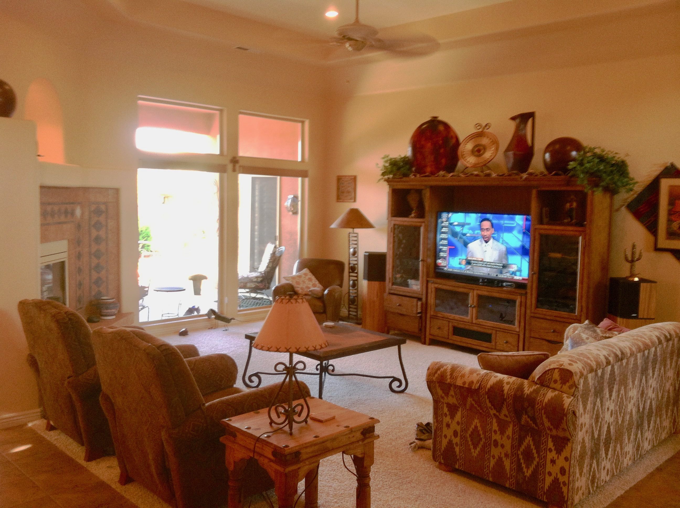

Hi, I'd appreciate some help from those wiser than me.....
I'm looking at used speakers (budget) for my main listing area/home theater.
The room is approx 24'x25' with high ceilings (roughly 6'000 cubic feet).
Currently I have a 90w Denon AVR 1912 and Hsu 15" sub. My current speakers, which I bought new about 25+ years ago, are Bose 10.2's. I'd like to upgrade them and I've narrowed it down to two 5 year old Salk SongTowers + SongCenter or two 2 year old Revel f208's. Both choices are around $1,900. The Salk's will have to be shipped (additional cost), the Revel's are 7 hours away. I'll eventually get a Revel center also.
The Revel's have some damage on the top edge of one speaker - the veneer is chipped. It's not noticeable in my sitting arrangement but is a reason for the lower price.
What are your thoughts concerning these speakers and the room size they need to fill.
Blessings,
Trvlngnrs

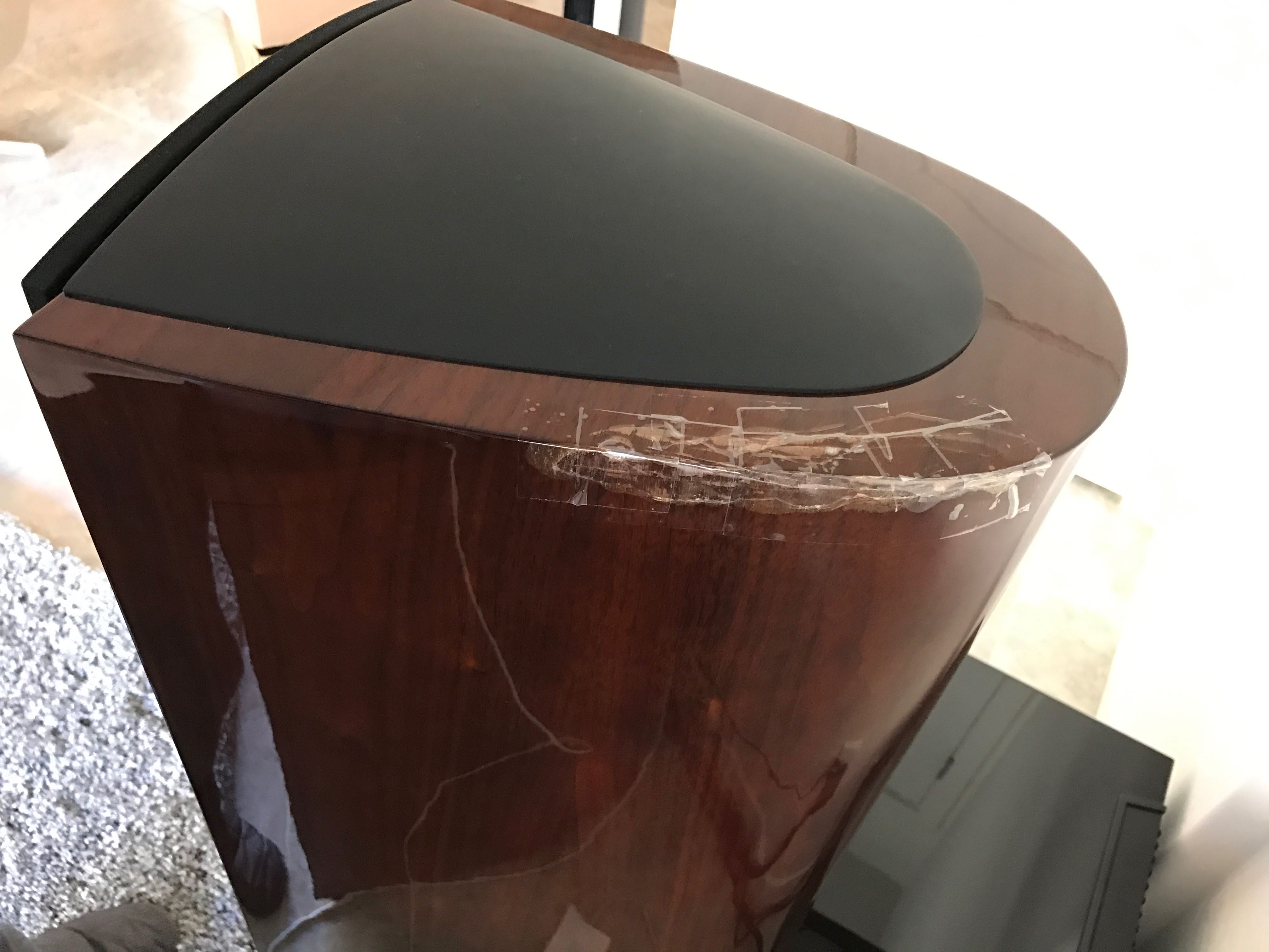

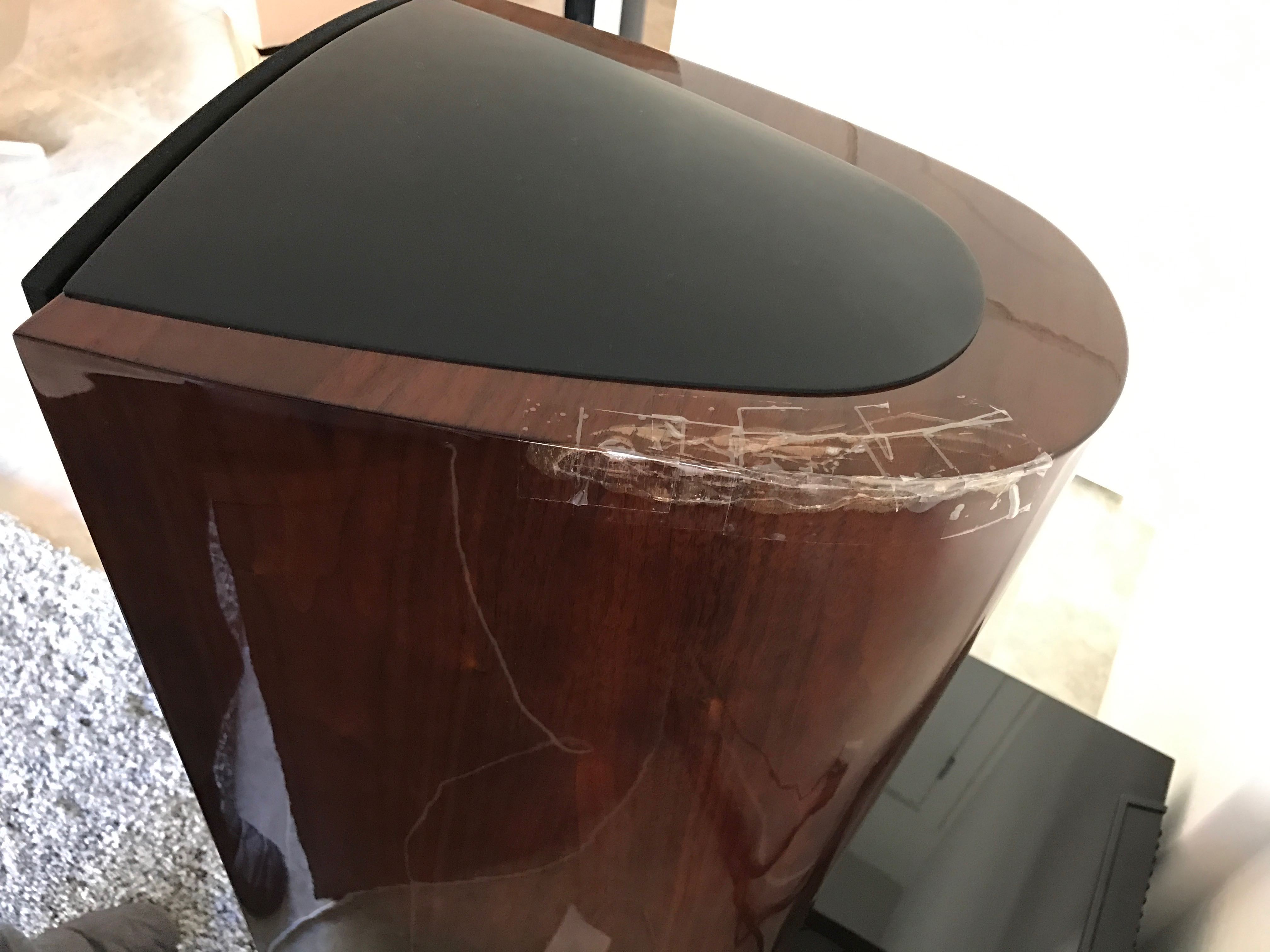

I got a photo of the damaged F208. My thinking is I could get him down to $1,700 and drive to pick the two speakers up. I called Revel to get some info regarding a repair but couldn't speak to anyone so I called two of their warranty companies - neither do cabinets.
What I would like to know is what the final coating on the cabinets are. Lacquer, polyurethane, etc? I could likely get a local cabinet guy to repair if it bothers me. I don't think it will since it'll go on the left side of my room, where the Bose 10.2 is now (since I took this photo I did some learning from this forum and have pulled the speakers a couple feet out from the wall). I could also put a piece of fabric or something over the top, etc. One of the reasons I like the Revel's is because they are front ported and have an boundary compensation switch that can be used to adjust them to allow closer placement to a wall.

That damage is quite extensive. I'd forget about the Revels. They might have structural issues too.

I agree. From the photo, it could be either a cracked veneer or finish, or something deeper, structural. Did they fall over?

I believe the Revel's were dropped when moving.
That should a complete deal-killer. There could be all sorts of internal damage. The seller really only has one F208, and probably the only way to get another one is to buy a new one, which will likely run ~$2000 + sales tax (in most places). The seller would have to sell you the undamaged one for about $700-800 for the deal to make sense.

I've owned F208s and they are excellent speakers but I agree with everyone else that the damage on that speaker is too severe to allow it any great value beyond the used parts value. The cabinet is a loser, even if it's structurally sound. That particular deal has been around for a while and it's no surprise there have been few takers. I've seen plenty of used F208s in excellent condition selling for under $3000 asking, and as low as $2600 for good looking pairs.
If you wanted a pair of Revels, you should wait for a clean pair or offer the guy $1300 ( or similarly low price of a single F208) for the beater pair he has with the hope it all works. If it doesn't, you're on the hook for another F208 but worse things have happened.
