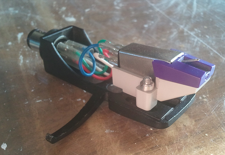

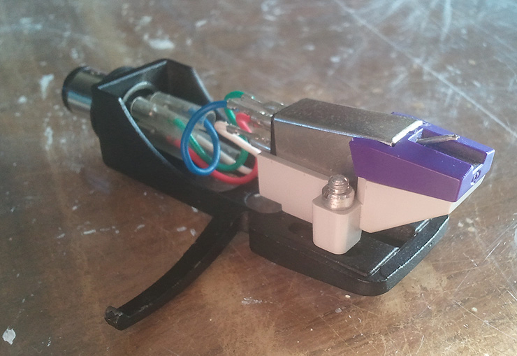

I feel a bit of a numpty. After doing more reading etc, I found that the stylus is JUST the needle (purple bit in the picture), I thought it was the "cartridge" as well. Does anyone know if the stylus for the Gemini XL series can fit the PT series? Again I don't know if it needs a new stylus but it look worn out to the untrained eye. I'm glad I put all this in the beginners section :(
You can't see the tip well enough with the naked eye to know if it is worn enough to require replacement.
