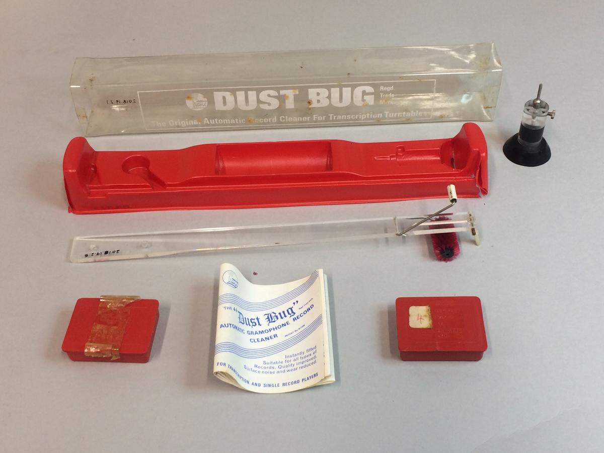

The answer to silent discs, is scrupulous record care. Once you foul a disc there is no easy answer. Cecil Watts showed that ALL fluids make the problem worse.
So:-
Don't put you fingers on the grooves.
Just have the disc on the turntable when in play.
Always have an inner sleeve. Make sure you put the record in the sleeve right after playing. Then put the sleeve in the jacket, so that the sleeve opening is 90 degrees to the jacket opening.
Dry clean only. I use a HUNT E.D.A. brush if there is any visible dust, which is seldom. It looks as if the are made by Music Hall now, but this is identical to mine.
I use the Cecil E. Watts Dust Bug for EVERY playing and have done for over 60 years. That is the only one that works, and there is data supporting that.
Those rules have worked for me.
If you have a fouled disc, only professional disc washers like the Keith Monks really work. The Keith Monks is the "Rolls Royce" of disc washers.
The best plan is to keep your discs in good condition so you don't have to use a discwasher. The washers that work use wet and vacuuming.
Lastly play in a dust free environment. That means no smokers.
