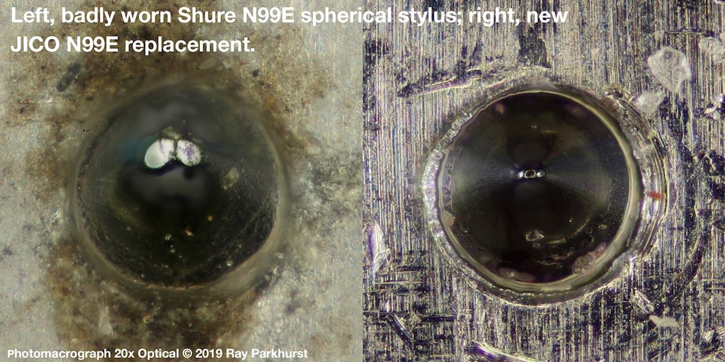

I was able to view it with my pocket microscope. Thx for that great idea @BFreidah. I don't have a removable headshell, so I removed the stylus to get a good look. I did look it up on the google machine what a worn stylist would look like. This seems to have chisel characteristics unfortunately. I'll look at the new one to compare since I am no expert at interpreting what I am seeing.

They don't become blunt, the contact points where it rides on the groove wear and become flat, as the photo shows.

So they both look the same. I put the new one in. And the original will be a back-up years down the road! Thx for the help!
