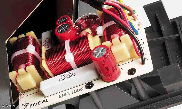

does anyone here know what caps Focal use on this crossover? I dont mean the values (uf or voltage) but what is compatible with the crossover. All i have figured out is that they are Electrolytic Bi polar Radial! There are so many caps used for various applications. I have found caps with the same values I am looking for but do not have a clue whether they are suitable for crossovers or not!!

You should also be aware that MPP caps will be physically larger than the equivalent NPE cap. If you intend to replace the NPE caps in the existing crossover board in your Focal 726 speakers, you probably won't have the space. Do your crossover boards look like the photo below? The NPE caps Focal used are radial. Both wires come out of one end of the cylinder, allowing them to stand on end instead of lying sideways. Most MPP caps come with one lead on either end. Fitting larger MPP caps on boards like the one in the photo will be trouble. You might be better off by building your own larger board.

You should also be aware that MPP caps will be physically larger than the equivalent NPE cap. If you intend to replace the NPE caps in the existing crossover board in your Focal 726 speakers, you probably won't have the space. Do your crossover boards look like this? The NPE caps Focal used are radial. Both wires come out of one end of the cylinder, allowing them to stand on end instead of lying sideways. Most MPP caps come with one lead on either end. Fitting larger MPP caps on boards like that in the photo will be trouble. You might be better off by building your own larger board.

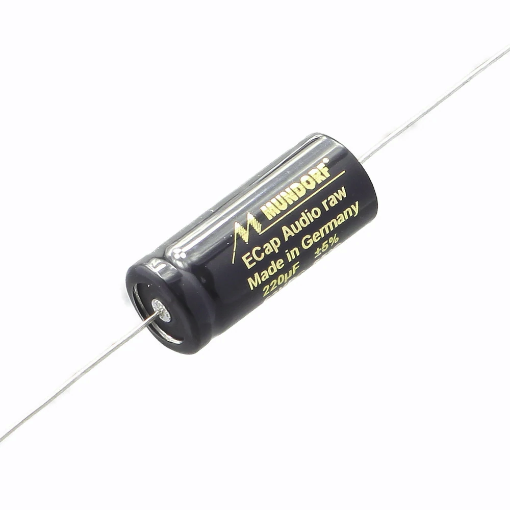

yep looks exactly like this! In the meantime ordered Mundorf's Axial Caps (couldnt find Radial anywhere) so it will be a bit of a challenge to connect to this crossover. I changed them all for peace of mind in the sense that I know that from 2022 all caps are new, not say some are +6 years old and the others new The Mundorfs I bought from the PLAIN series are highly recommended (and costly)and as some mentioned I probably wont hear sonic differences but again for peace of mind I know i have quality products that SHOULD bring out the best in my speakers.

I just bought the Mundorfs, yes quite expensive and i am sure I will not hear any sonic difference easpecially with the music (rock ) i listen to! But as i mentioned o another contributor here, i wanted to change them all for peace of mind knowing that from 2022 all caps are new, quality ones.
Too bad you didn't ask here before ordering those Mundorf caps. I hope they weren't terribly expensive.
What capacitance value (microfarads, µF) and voltage rating are they? The capacitance value matters the most. ±10% is OK in crossovers. Voltage ratings refer to the maximum voltage they can withstand before failing. In speaker crossovers, 100V is plenty. Higher voltage ratings will make for a larger cylinder.

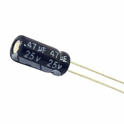

Axial and radial mean different wire lead locations on the caps. Radial leads allow a cap to be stood on end. Axial leads are more easily wired if the cap is lying on its side. Electronically they are not different.
A radial cap
An axial cap

The one issue you may find is the physical size. Mundorfs are often quite a bit larger than Audyn and as you are replacing a radial capacitor with an axial you will already have a challenge fastening it down. You may find that the Mundorf is simply too big.

Axial and radial mean the same thing in caps. It depends on who translated it to English.
An axial cap
A non-axial cap
yes im aware of the harrowing task ahead but have been chatting to engineers in the uk who have been giving me options. If i cannot install the axial vertically (by bending one lead....and extending the lead if neccessary) I can leave the caps 'in air' (ie leads soldered to the board obviously, but the cap itself elevated over other components as it bis not going to move anyway). I'll see what works best at least now I'm smiling ...
