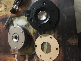

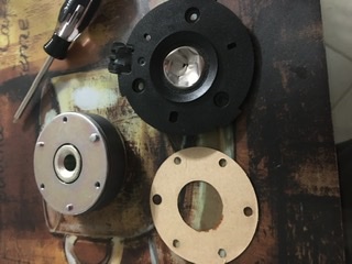

Well...I received the replacement speaker today, the same issue, glue failure.
I have two of them now, anybody know the gorilla glue lady’s phone number?

I'm having trouble telling from the pics what needs glued to what.
Old Onkyo
Old Onkyo
Post #16, the plastic piece should be glued to the magnet. If you look closely at the plastic you can see a clear square patch that was glue.
The second photo shoes the tweeter I removed, I am holding it like that to show how the original piece is, and how strong the glue job is.

So much for the famous quality of Bowers & Wilkins proprietary drivers!

Done! I did not use glue. I removed three screws on the face of the speaker and changed only the dome on the old speaker.

They probably had a three page color brochure on that tweeter.

I'm surprised they didn't screw that piece to the back of the tweeter plate and fasten that to the rear of the cabinet- Monitor Audio has done that and it makes tweeter replacement easy.
