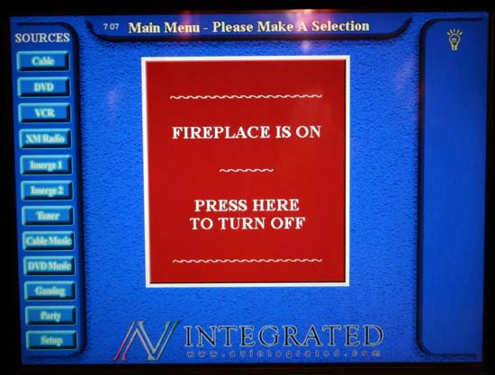

Nothing short of Crestron, AMX, or some other high end control system will really deliver what you want, and you will still likely be left a bit short depending on the exact functionality of what you want and the depth of control that's available from the gear you actually own.
The biggest mistake people run into is that they buy gear and think because it has some nifty form of control, that the control itself isn't 100% proprietary, or protected by the manufacturer. Some control protocols may be excellent, but could take 40+ hours to write for a single product, if it doesn't exist already, especially IP controls.
Yet, it would be incorrect to say it can't happen. My home system offers 14 zones of audio, with two DVRs distributed to four HD displays in my home and includes a digital music server, XM radio, tuner, etc. throughout. All distributed and all available through local controls, or through touchpanels. My four year old has almost no issues, my wife even less.
It is a Crestron system, with a fair bit of Crestron product, but I use the MX-850 remote, which talks to Crestron, to achieve most standard control.
