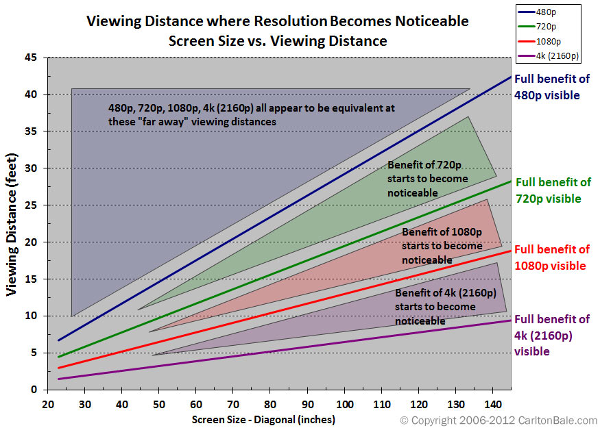

I wouldnt keep it for the full 20,000 hours. I would upgrade before then. I was able to move my couch forward. It is now 15.5ft away. Will i notice a difference between 4k and 1080p? Some people were telling me that at 17ft away i wouldnt see a difference in 4k over 1080p.
Also am i too close to my 1080p at 15.5ft?
This is a common reference image for resolution vs. viewing distance.
At a 135" diagonal you can be as close as about 8' to obtain maximum benefits from full 4K imaging. At right about 17.5' is where you don't get any resolution benefit from 4K.

Cool when i get a 4k projector i can move my couch 2 feet towards it. From 17ft to 15ft. 15ft will work fine for 4k right? And would 15ft be too close with my 1080p right now? Thanks for the graph.
I don't think most people can easily see the difference between 1080p and 4K with similar content. It's only the highest level content where 4K shines over 1080p, and as I've said, it's more about the color depth and if HDR is in place that things can get really noticeable.
Viewing distance is as much about resolution as anything else. So, when you are in the 15' range, it is possible that you may be closer than 1080p can give you overall, but whether it bugs you or not is more a personal choice than a hard set rule.
I would be surprised if you were unhappy with 1080p content moving a couple of feet closer. Some people don't like the size when they move closer, but others go even larger and sit even closer. I'm about 16' from a 161" screen, by example. Others sit about 8 or 9 feet from a 133" screen.
