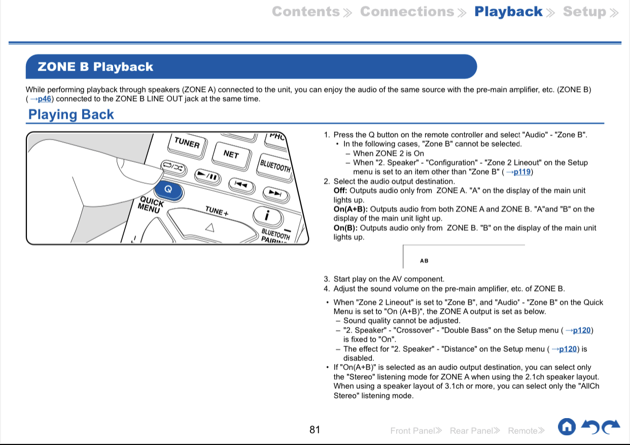

It's been several months since I have recorded an LP to my laptop. Sometimes when I haven't done that in a while, my settings need to be re-established using this attached page. "Zone 2" was greyed out, so I fixed that by going to config and setting zone 2 to "zone B". Went to record and no signal. I hit Q on the remote again. The options for audio are: off, on (A+B) and on (B). with zone B off, I get no signal to my laptop. With "on (A+B)", I get a signal, but the speakers are in 7 channel and you cannot change it to stereo. Display says "not available" when you try. What step am I missing? I betcha @Trebdp83 knows what it is.

The Zone 2 Pre Out setting was used last time. Go into Speaker Configuration settings and set Zone Speaker to No. Then, set Zone 2/B Pre Out to Zone 2.
You can power ON Zone 2 from the remote controller by holding down the ZONE 2/SHIFT button and then tapping the power button. While holding down the ZONE 2/SHIFT button, tap the PHONO button to select for output in Zone 2. You can also use the Onkyo Controller app in a Smart device to control each Zone.
The volume level from the Zone 2 Pre Out is Fixed by default but can be switched to Variable . Stereo mode will be selectable in the Main Zone when using Zone 2 instead of Zone B.
This is awesome! Works great of course now. I'll refer back to this post if/when I need it. Because I will forget some of this probably! Thx again!
