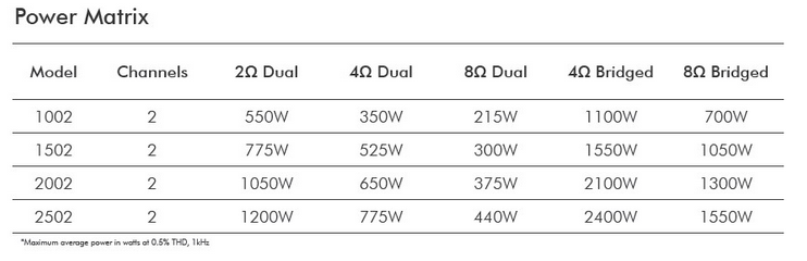

I have a choice between XLS 1500 and XLS 2002 as I have both.
HF is rated 500W RMS and 1000W Peak,
HO is rated 800W RMS and 1600W Peak.
Here are the ratings of the Crown amps. The XLS 1500 has same specs as 1502 below.
Which driver-amp combo would be recommended? Would I be able to add a second sub later using just one amp in dual mode?

Sounds like subtle differences. I can live with either. I am thinking I should pick based on what the amps can handle instead.
If you are going with a single HO driver and you want the most performance out of it, a single 1002 is all you need and it would be overkill for a single HF. If you are going with dual HF subs, a 1502 or 2002 would do the trick. For dual HO drivers, go for a 2002 or 2502.
I think i will go with the HF sealed and pair it with 2002. Would prefer sealed as is easier to build, also prefer a musical one. As i understand it can also go quite low if i go with a larger box. I have power, and flexible with size.
