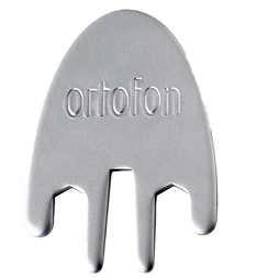

I am satisfied with it, but I will tell you it's a HUGE pain mounting it. A lot of fiddling which only raises the risk of bending the cantilever. Come to think of it, remembering the ordeal, I'd probably give twenty bucks for this tool just to avoid the next time:
