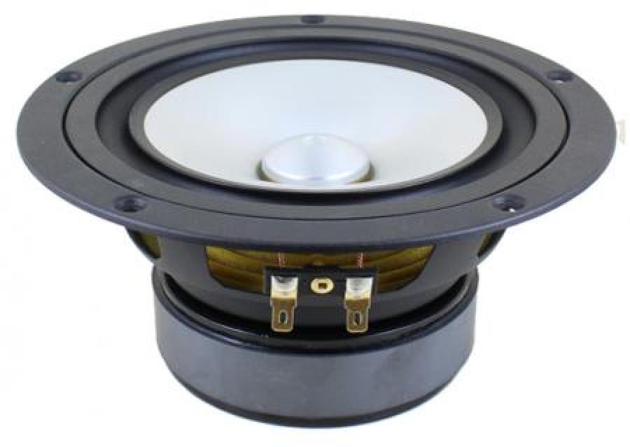

I would use these.
The best speaker I think for ceiling speakers for Atmos is a really good full ranger. Most ceiling speakers are a hopeless mess. The ones you picked out make more sense than most.
I have used four JW full rangers from my stock of those phenomenal full range drivers. Three shown here.
Back boxes were made for them. I am of the view that ALL ceiling Atmos speakers should be enclosed.
The finished result. You can see two of them in this picture.
Unlike RSL I will show you the FR.
They sound superb. They are natural and very realistic. I have been very happy with them, they have not put a foot wrong in that application.
Those Mark Audio drivers are the direct descendants of those JW full rangers. The late TED Jordan handed all his engineering over to them in his final illness.
I am absolutely certain they are the most optimal speakers fro Atmos duty.
If you are interested I will calculate the optimal back box for those Mark Audio drivers. The ones I showed I specifically designed for the JW drivers in this application.

I think it actually important to box them if only to prevent driver over excursion. I think they should have the restoring force of box pressure. It is not hard, but you need T/S parameters to size the box.
I have to say I have very serious reservations about the way ceiling Atmos speakers are installed and implemented. It is far too crude and not satisfactory for purpose.
I built the calculated optimal boxes for those JW based on my measurements of the T/S parameters. Correct engineering makes a difference and leads to optimal results.
