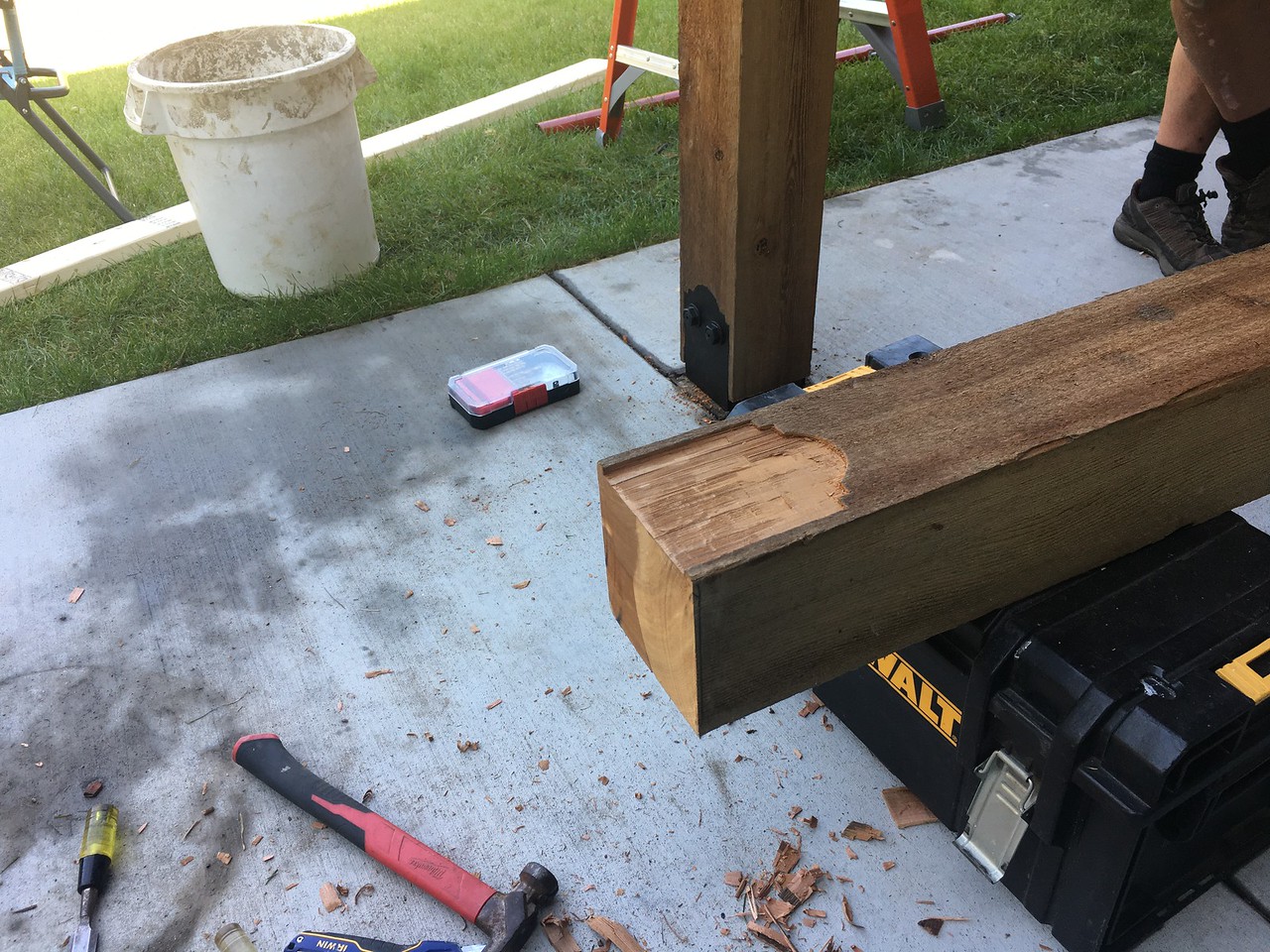

There were a number of irritations. One major one was the cedar support posts. I was preoccupied with getting the mounts for the barbecue and generator I had made correctly installed. I told the builder not to install the posts that way, but they did any way and put them down into the concrete where they would rot.
They did not attach them to the roof securely and when the building inspector saw it he had an absolute fit.

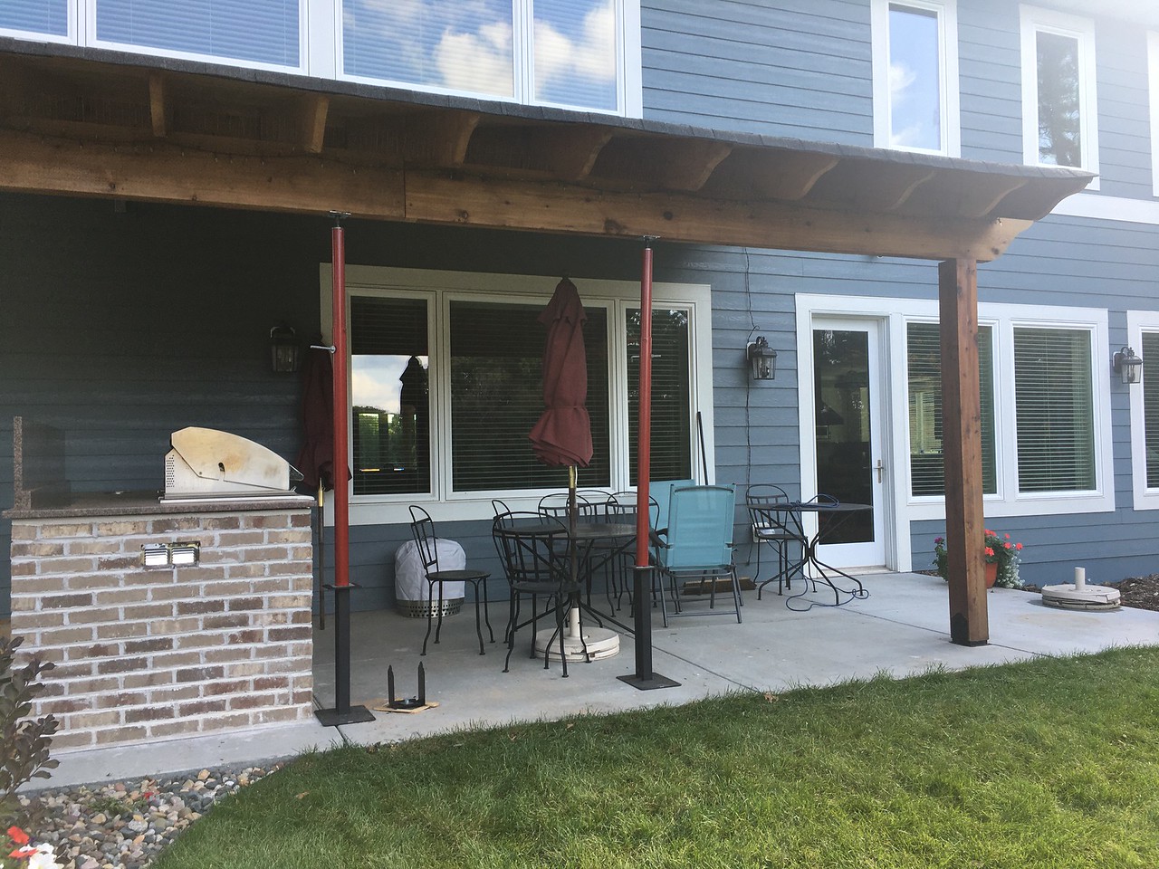

Then I ended up having to take care of it. My audio hobby came in handy.
I had to buy screw jacks. I could only get ones too short at reasonable cost. However I bolted them to a couple of loudspeaker stands I had around.

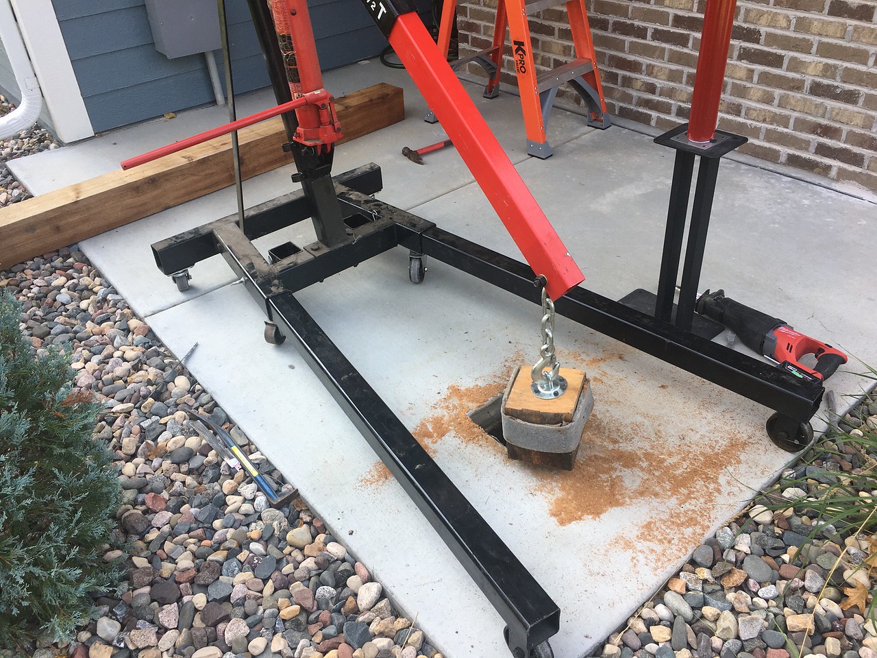

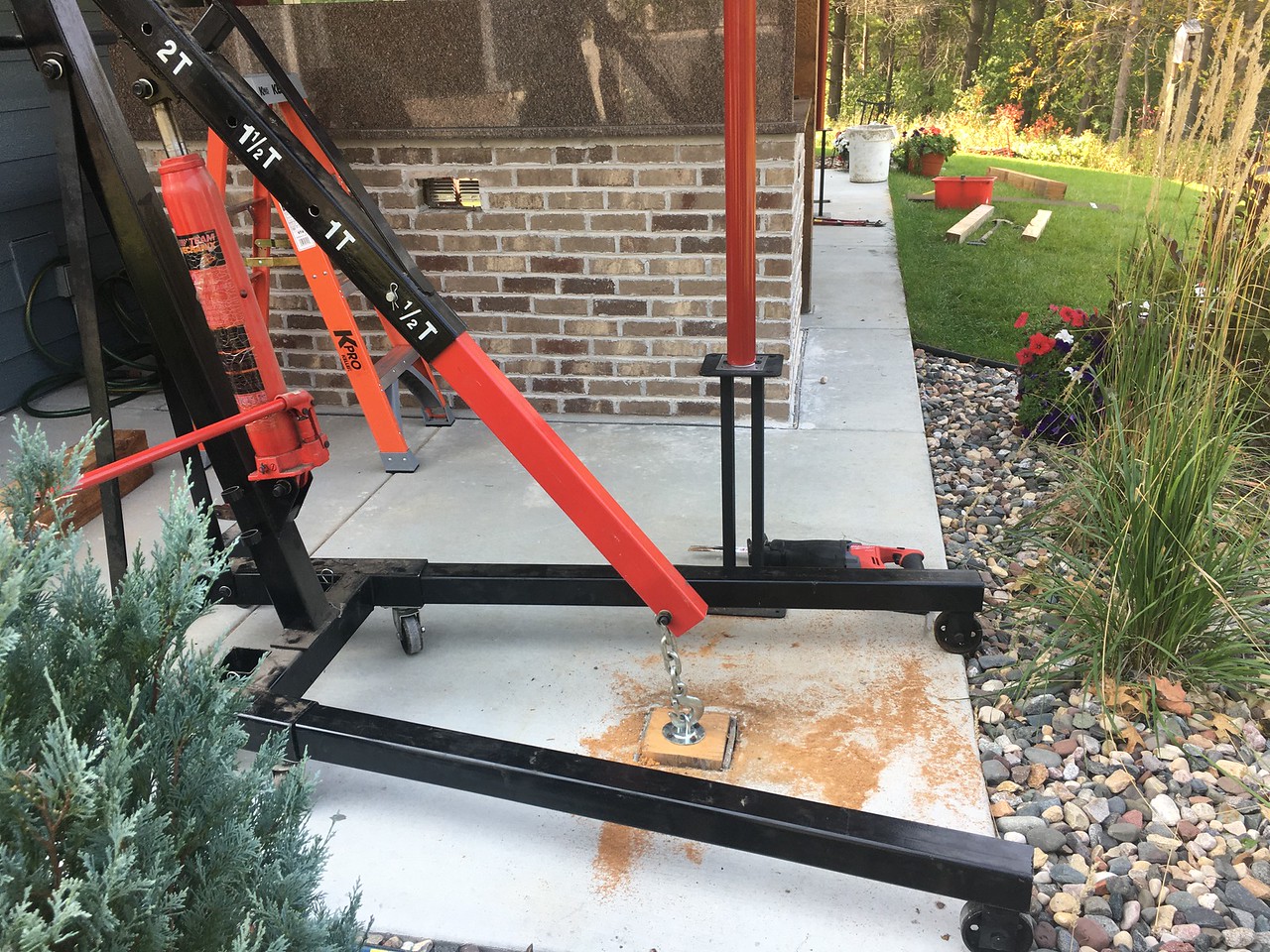

The bottoms of those columns were very hard to pull out. Fortunately I had kept my engine lift and not sold it in our auction. So we pulled them out with the engine lift.

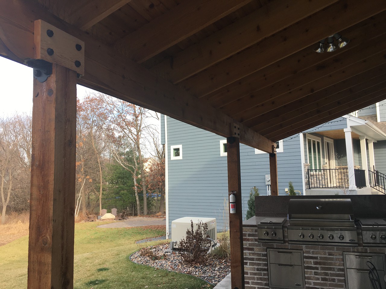

This is now the bottom fixation, with the brackets secured by L - Anchors set in concrete.
This is the top fixation.
I'm glad to say that job made the inspector happy. I honestly think the builder did not know how to correct it, and kept putting the job off. I damn well charged him for it though!

The use of the speaker stands was ingenious. I'm surprised you managed to get the post out of the concrete given the snow in the previous photos. Posts in Ontario have to be 3 or 4 feet below ground level to get below the frost line but I guess that's not an issue in your area.
Nice touch on mortising the bracket. That must have been a pain to drop onto the bracket with the roof in the way.

No it was not difficult to place the supports back. The screw jacks were able to lift the roof enough to easily place the supports and lower the roof back down on the supports. We had to mortise for the brackets, as that was the only way they would fit.
The structural engineers drew the correct way to install those cedar supports. That was one of the things that really annoyed me when they went ahead and did what they did.

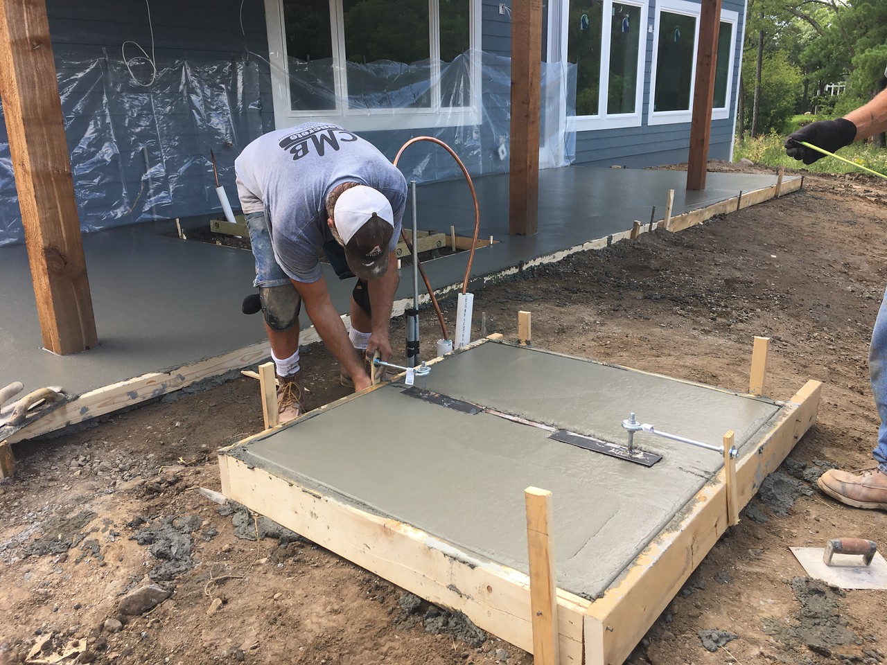

The small slab is for the auto start generator.
That mounting was my design. The company supply a plastic mounting base. I was having none of that. The crew that came with unit to install it, told me the plastic mounts are hopeless and do not do the job, as I suspected. You really have to bolt down generators, and that one is fastened down hard, and will not go 'walk about.'!

The posts have to be below the frost line? Can't you put in 4-ft concrete footings in sonotubes?

You can use either depending upon the situation. For fence posts, you need them below ground for lateral support, so a 4 ft hole, little bit of gravel at the bottom for drainage, drop in the post and concrete all around. If the concrete is above soil level and sloped away rotting should not be an issue. They make concrete mix for fence posts that you can pour in dry and then add water afterwards which makes it very easy but I still prefer to mix my own for proper consistency.
Sonotubes are optional for fence posts but do help with frost heaving as the soil will slide over the tube. For support posts like pictured above, footings and metal bracing is better because you can replace the post without having to redo the footing, as long as the proper lateral support is in place but I think I'm stating the obvious there. What that contractor did with the post only a few inches in the ground was a definite no-no.
I prefer to do my own work, if at all possible. We've hired contractors twice in the 23 years we've lived in our house - one to replace our shingles and another to replace our windows. I'm quite capable of doing both jobs, but I was leery of having friends help with the roof because of liability concerns, even though they were quite willing to help out. And, while I can install windows, it would have taken me forever to do get them all done and we (I mean "she" :rolleyes: ) wanted it done quickly. Happily, both jobs were completed very well.
Code here in Eagan is a minimum depth of 42" for Sonotubes and all concrete footings.

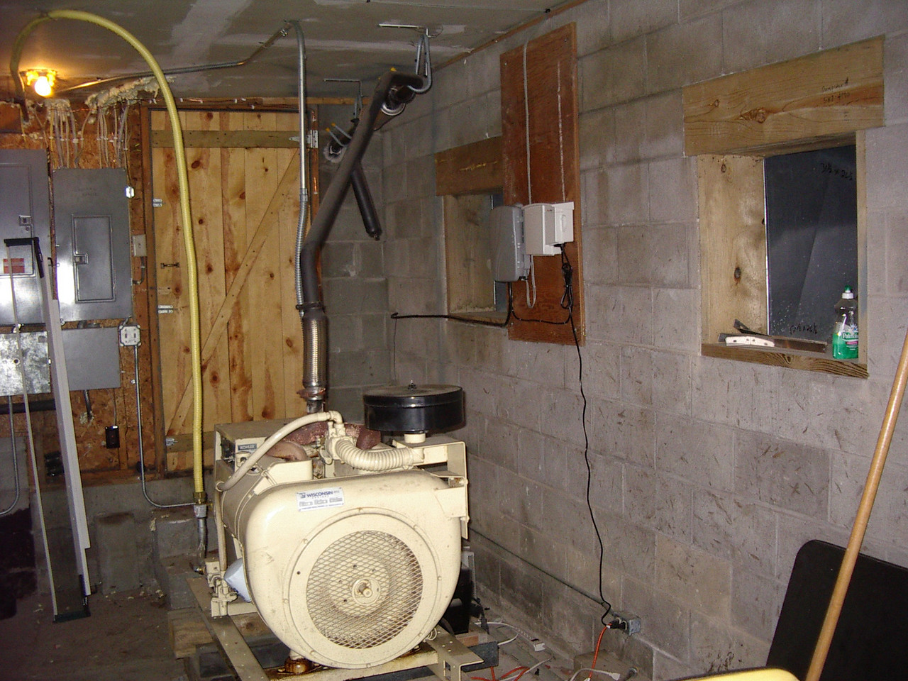

At the lake I had a vintage Kohler unit of the same power. It was an old RMY unit with the Wisconsin V4. That was a workhorse agricultural engine with quite a vintage bark.
