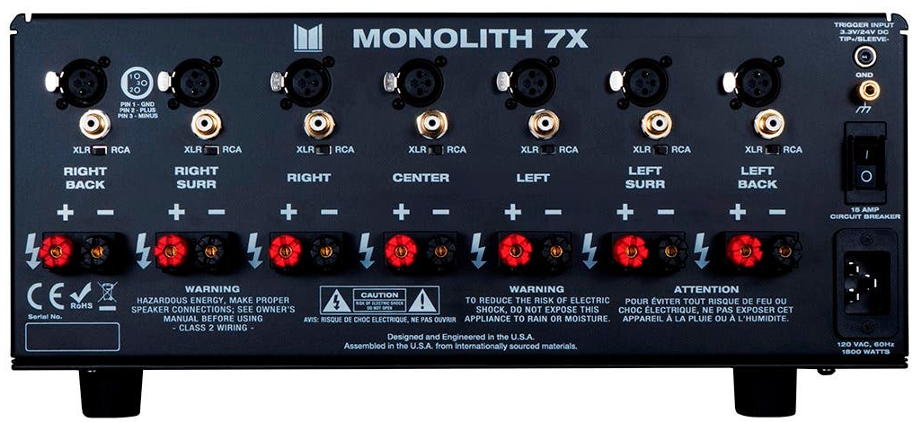

The Monolith 7X power amp shows 1800 watts on the back panel with a 15 amp circuit breaker. 1800/7 = 257W per channel. When I use a Kill-a-Watt meter to measure energy use with all 7 channels driven at a volume of 65 on the Denon 4700 with Auro-3D mode it displays 200 watts.
When the volume is 35 the Kill-a-watt reads 158 watts. The amp seems to require approx. 150 watts to turn on and only rises by about 50 watts when you get to 65 on the volume. It's hard to imagine energy use rising 7x. Is it possible the 1800 watts is simply reflecting 15 amps?
Is there a class D amp that offers the same amplification and quality as the Monolith 7X at a similar price point?

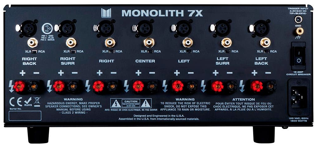

The Monolith is an ATI amp and they are honest about power ratings. The 1800 watts is likely close to a max rating so if you factor 70% max efficiency, that's about 1250 watts available to the speakers / 7 = 180 watts/ch.
