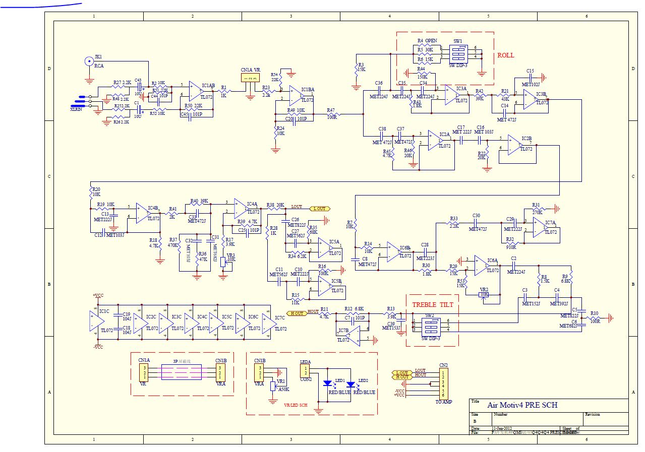

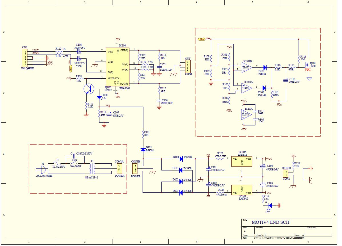

The Speaker Caps need full replacement on my 6 year old Emotiva Airmotiv 4
I took them in to a local repair shop that quoted me $200.00 for a complete recap of both speakers, does that pricing sound fair? I am asking because I have no idea, but will be tossing the speakers if that is the case. They only charged me $50 to diagnose which could be applied to repair, which I thought was fair.
Emotiva was nice enough to send the schematics, if that helps at all

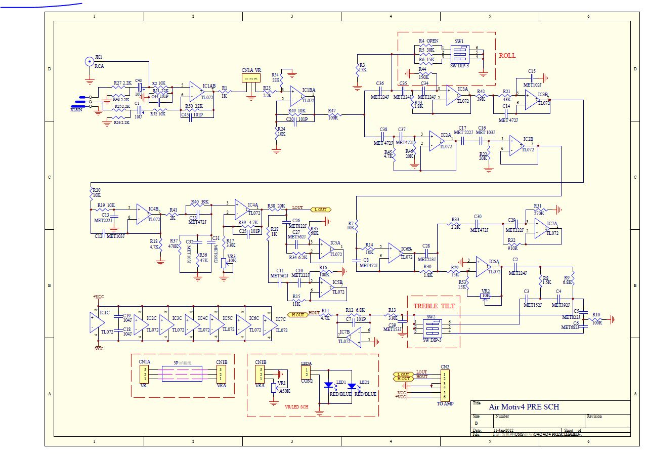

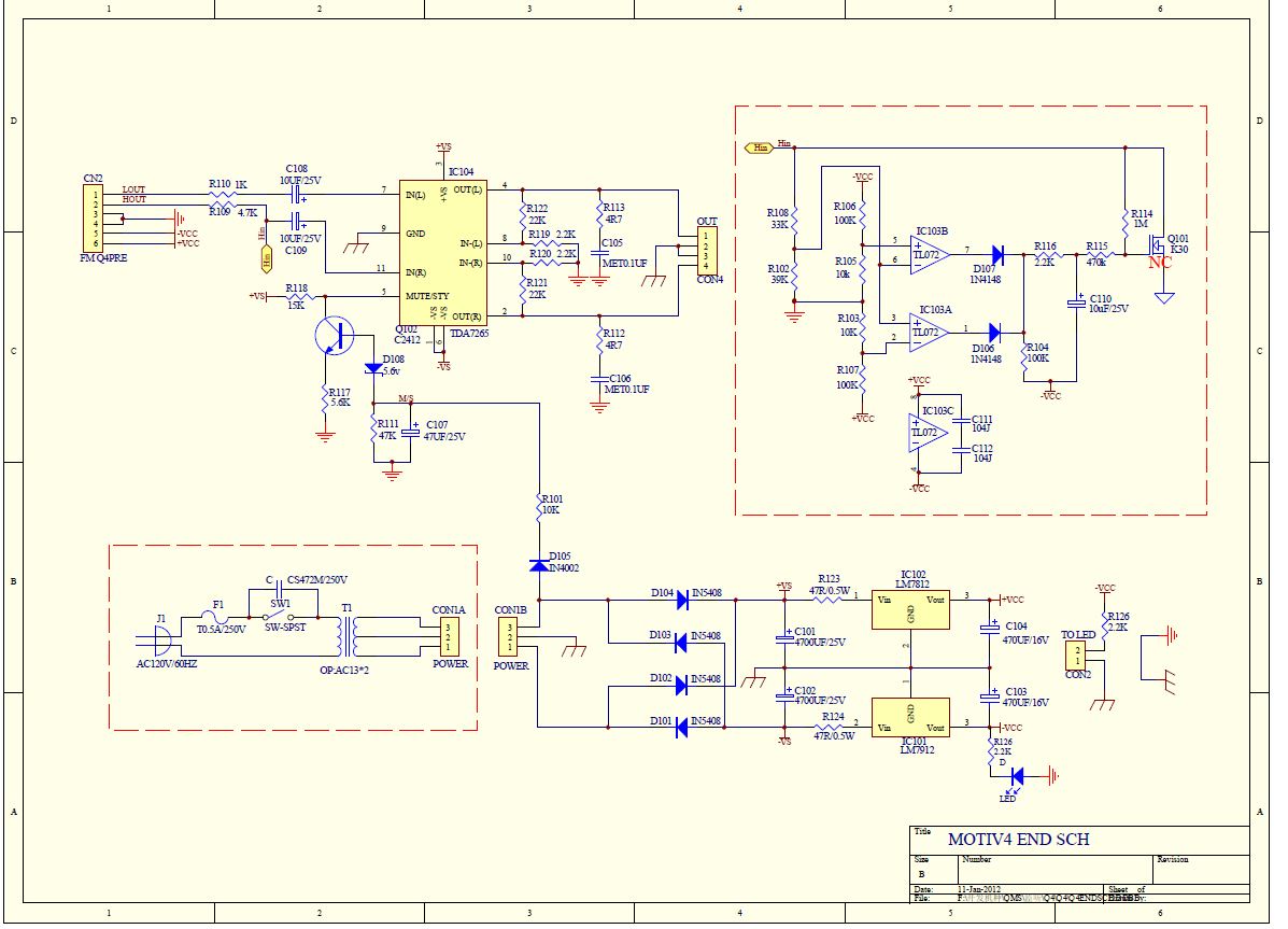

View attachment 53886View attachment 53887
I find it hard to believe that 24 caps need replacing after 6 years. I have never heard of such a thing. If true then that is a new low in modern manufacture.
If all those caps do need replacing that is a more than fair price, as that will be close to a day's work.
Have you really pushed them as to why all 12 caps in each speaker need replacing?
Did both speakers fail at the same time and the same way?
When I had my 60 year old Quad 22 preamp restored there was only 1 bad cap after 60 years. That is a tube unit, were the voltages are 300 volts across some caps.
Only the bad cap was replaced. If those speakers really do have 24 bad caps after 6 years, then I'm pretty much ready to despair.

That is just the output stage producing variable DC off set as the power supply rails ramp up. This is common, with most amps having much worse noise. So much so that they need a relay on an LM timer circuit to cut out the speakers for 10 sec to prevent damage to the speaker.
They could have changed all those caps and and made it worse just as easily. In any event, most of those caps have nothing to do with creating that noise. So the advice they gave you was WRONG BAD ADVICE. It stood a good chance of damaging a circuit board. That shop does not earn good reviews in my opinion. I would not seek their advice again.
