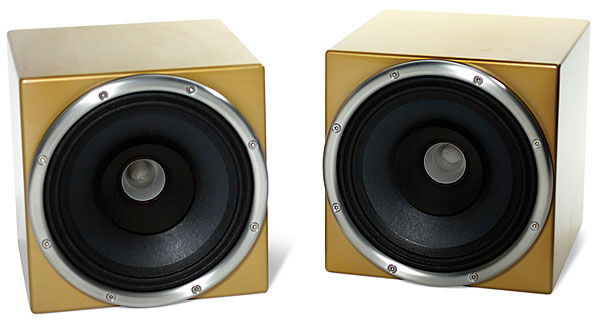

I picked up a pair of Zu Cube speakers in a trade. I was really shocked at the transients this speaker can relay. But there is something that’s just off enough to my ears that it’s bothersome. I’ve played with positions, amplifiers etc. My current gear is all Rotel. I have never touched a treble or bass adjustments. I find my best result is to get this speaker out of the low end all together. Crossed at 200 hz. My sub is a surpurb RBH 12” Reference.
sooooo close to great sounding system......dang it.
help
help

It's no surprise that these speakers don't do bass well. Their name, Cube, suggests small size, as with other cubes we know, but they're 10" diameter coaxial drivers in a cabinet barely large enough to contain them.
If those are the same coaxial drivers Zu uses in it's much larger floor standing models, it's no surprise that they lack bass.

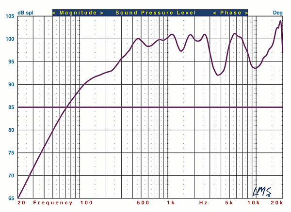

See the Sound & Vision review. Ignore the reviewers comments, and go straight to the Test Bench page.
S&V's frequency response curve shows a lot to dislike. They lack bass below about 350 Hz, and their response above 1 kHz is ragged, to put it politely. To be more blunt, I'd say it's frequency response makes these speakers unacceptable.
How much do you want to spend to replace what you now have? Bookshelf speakers or floor standing?
Look for 2-way or 3-way speakers with much smoother frequency response that's flat over as wide a frequency range as possible. And look for speakers that disperse sound widely over the entire mid-range and lower treble, the voice discrimination frequency range. The above FR curve doesn't show dispersion (off-axis FR), but the reviewer did say:
This is a very directional speaker. Its dispersion is narrow, so when I stood up, treble detail and air took a nose- dive. The upside to narrow dispersion is that the Cube reflects less sound off side walls, the floor, and the ceiling than wide-dispersion speakers do; consequently, the Cube projects an unusually focused soundstage.
That's speaker reviewerese for "these speakers beam sound too much to sound good". Their "unusually focused soundstage" requires a listener to sit imoble within a tiny sweet spot to hear any stereo image at all. You'll need an audiophile-grade head vise.
I wouldn't worry about impressive sensitivity numbers. Your Zu's are very sensitive, roughly 98 dB, based on the above curve and what Zu claims. But, as you've found, that doesn't help them. Amplifier wattage is cheap, and good sounding speakers are expensive. Instead, look for reasonable sensitivity such as 86 dB or higher.

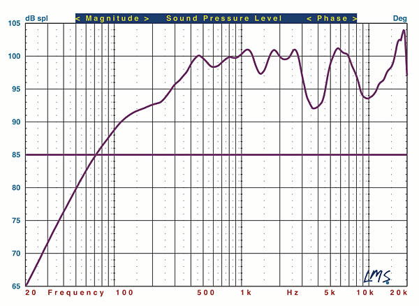

I observed the exact same thing when I put them on
my mic. There were two really large dips in the critical midrange. As a comparison, I added my tests show a combined graph of my L100T and L200T3. If I was testing a newly built speaker and it looked like this, I would fail it.
