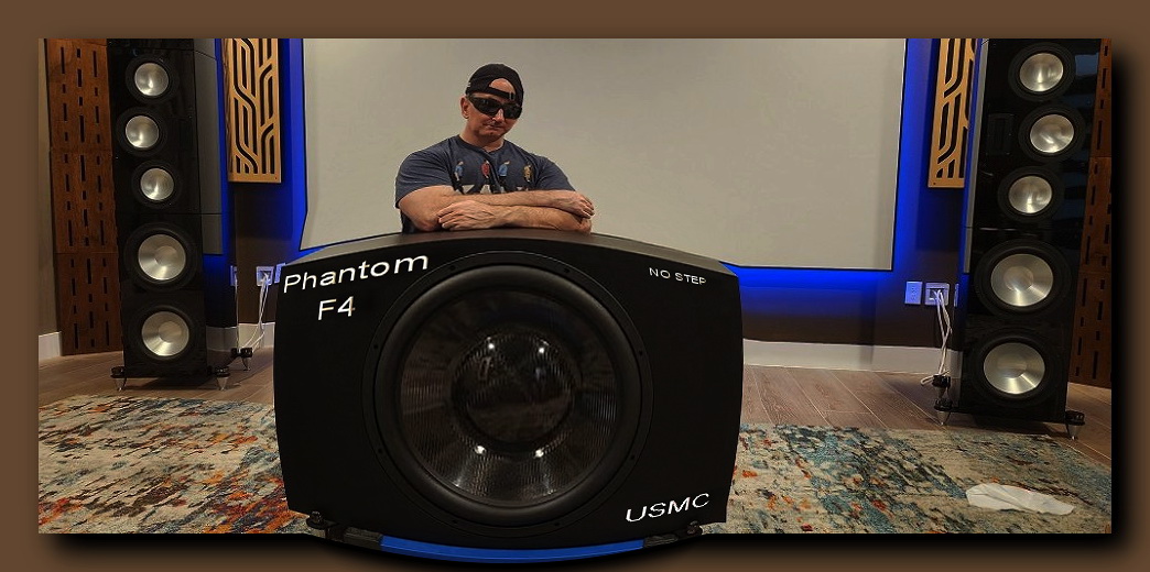

Gene love the gangster look with the sub. What a monster! I need a bigger house so I can put in all this amazing equipment. Or maybe I should start with the equipment and build the house around it. I know where I’m spending my money if I hit powerball.
