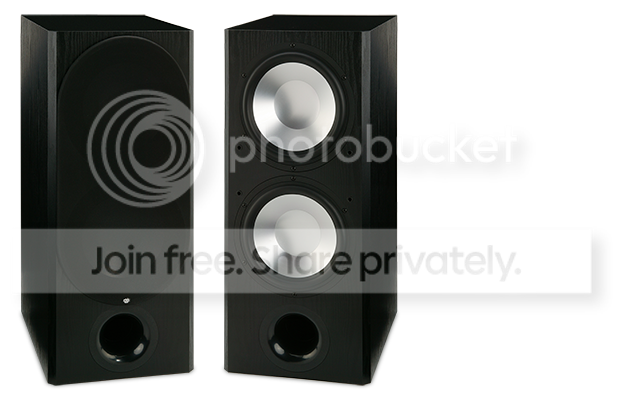

I've got this sub in a roughed up cabinet and because this amp didn't work (on at least the line level inputs). The amp powers on but has no output. I'm not really sure what to do with it. I do have a couple of Marantz MA700 amps (200w/8ohm 300w/4ohm) to use for power.
My thought is to remove one of the drivers and modify the cabinet's volume and port to optimize the remaining driver based on T/S parameters. I'm hoping ADTG can dig those up. Then I would build a matching cabinet for the other driver. My first requirement in a sub is having two subs. I have two matching drivers so I'm calling that a good start. I need help with the alignment.
I know I'm mostly talking to Mark so here's what else I have on my mind. I have some random but decent drivers kicking around. Namely an OW1 tweeter and at least one 4" Infinity midrange that came out of a Primus line speaker withh that MMD cone. I guess I have the makings of one Primus 360/362/363 speaker plus that killer OW1 tweeter and I would like to make a center channel using that OW1 tweeter.
I doubt you will get much out of that sub with one driver per cabinet. If you do as you suggest then you will loose 6 db of output compared to the current arrangement. If they were side by side then you would loose just 3 db of output. Separated 6 db. I don't see this as a plan justifying the effort, unless those drivers are really spectacular. I would drive it with an outboard amp. It is ported so Eq in not and issue. Obviously the T/S parameters need to be known for the porting. Enclosure volume would need to be halved, as VAS is halved under your plan.
The other is highly problematic. Center speakers are really hard to design. The toughest of all, I just designed one last week.
Now the tweeter I'm familiar with, but I have no idea what the T/S parameters or the acoustic responses of those other drivers are. So there is no starting point for a design right now.
So project one is probably unwise. Project two has a highly dubious prospect of success. Much easier to start with a clean slate.
