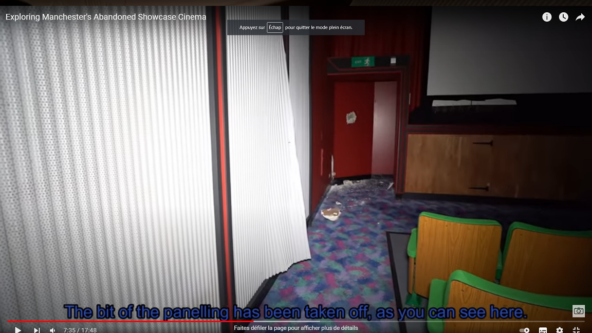

Back to the topic. Do you know what king of acoustic panel is this (filmed inside an abandonned movie theater from year 1989):

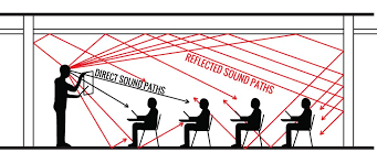

All room with a speaker system will have the first arrival direct sound and then a myriad of secondary reflections. Like this:-
If you cancel those crucial secondary reflections you get bad sound period. However those secondary reflections largely come from the off axis response of the speaker. So if there is discongruity between the axis and off axis sound, then there is a problem. In a room the time delays between the two are not long enough to impair speech intelligibility. However in a large movie theater long reflection times certainly would impair speech clarity, and so taming of reflections is required.
