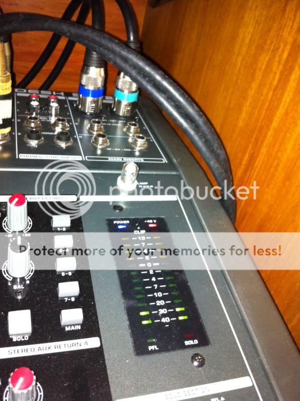

why is the led meter on the right not equal to the meter on the left ... sometimes.
first pic above, unbalanced L and R meter readings.

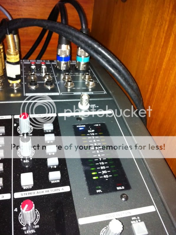

second pic, no change in anything but now the same readings.

What are you running through it? Stereo signals will have different levels in the left/right channels and that is normal. If you are running mono then make sure nothing is panned. Other than that, I'm not sure. Your first pic shows nothing on the right channel. Do you have stereo speakers connected? If so, in that situation, is the left playing louder than the right?

3) yes in the first pic, it would take 3 bars on the left to 1 bar on the left. second pic, no change in source (just the mics) and the right meter bounced back up

Mike asked me on FB to help out here.I see that when the 48v is on that both signals are even.What are you running in this desk Mike? Do you have any 48v stuff you are powering out of the desk? I can't see but usually there is a 2 track to mix button, is this pressed? What model is it? Ok sounds like you need to listen to the speakers and see if they are both on while the pulpit mic is on.I would guess if you are running program music thru there then possibly one of your mix buttons isn't pressed or you have a bad rca ..when the mic is on is it panned to the left?
wow, i did not notice the 48v thing. i could have sworn i turned that on for the first pic.
but even when the 48v was off when keyboards and wireless mics were running, it was unequal as well. and i think even with the 48v on, it was unequal as well, will have to reconfirm the latter this sunday.
