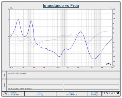

I am looking to buy the R55Ti towers(E55Ti towers). I read the reviews on the Audioholics page and noticed that they dipped down to 4ohms at times. My Denon avrx3000 does not support 4ohm is this going to be a problem. Or because they are rated at 6ohm and generally stay above 4ohm will these be ok. This will be my first purchase of better than walmart brand speakers and do not want to spend the money and run into problems.

Are you referring to the one reviewed by Gene.
http://www.audioholics.com/tower-speaker-reviews/emptek-e55ti/e55ti-measurements
They don't seem hard to drive but if you hear any sign of distortion, turn it down and all should be fine.
Swerd
Swerd
The impedance curves for those speakers look like they should be easily driven by most receivers.
The review said "My personal feelings are that EMP could have put a bit more effort into optimizing the impedance of this speaker, at least in measurement, as I didn't find the E55Ti's to be a difficult load to drive for any of the amplifiers I tested them with."
Pay most attention to the last part of that sentence, which I bolded.

Your receiver does have some build in protection scheme that would shut itself down before it gets damage. As others commented, your AVR should be able to drive those speakers well enough but if your listening habits and environment do call for more power then you may be left with little choice because the X3000 does not have pre-outs for external amps. For movies, if you set the crossovers to 80 Hz, the subwoofer will take some load off of the receiver too.

Speakers usually dip into the low numbers deep down in the bass range. Since you'll be using a sub, and assuming it's properly adjusted, that should handle all the deep, deep bass and relieve your mains from that task. So, you should be golden.

That's good too, but with the sub handling the deep bass, even if you run your mains full range, unless you boost the s&1t out of the bass on the amp and drive it hard, they shouldn't stress your amp to begin with.
If those speakers were that dangerous to amps, they wouldn't sell to many of them. A lot of speakers dip low at some point, it's just nobody bothers to mention it. ;)
