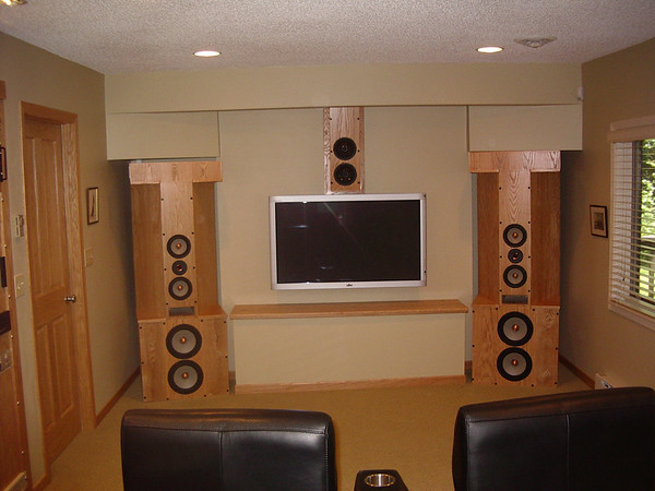

So in essence if you want a good three way speaker, it needs to have large bass drivers in a big enclosure, and preferably have at least the low pass/band pass crossover active, and require two amplifiers or more. This is the route I have taken, but the enclosures are large and complicated, not only because they are transmission lines, but to handle the imaging problems. They require three power amps to drive each speaker. However they are genuine full range speakers not requiring a sub.
You can build a set if you wish!
