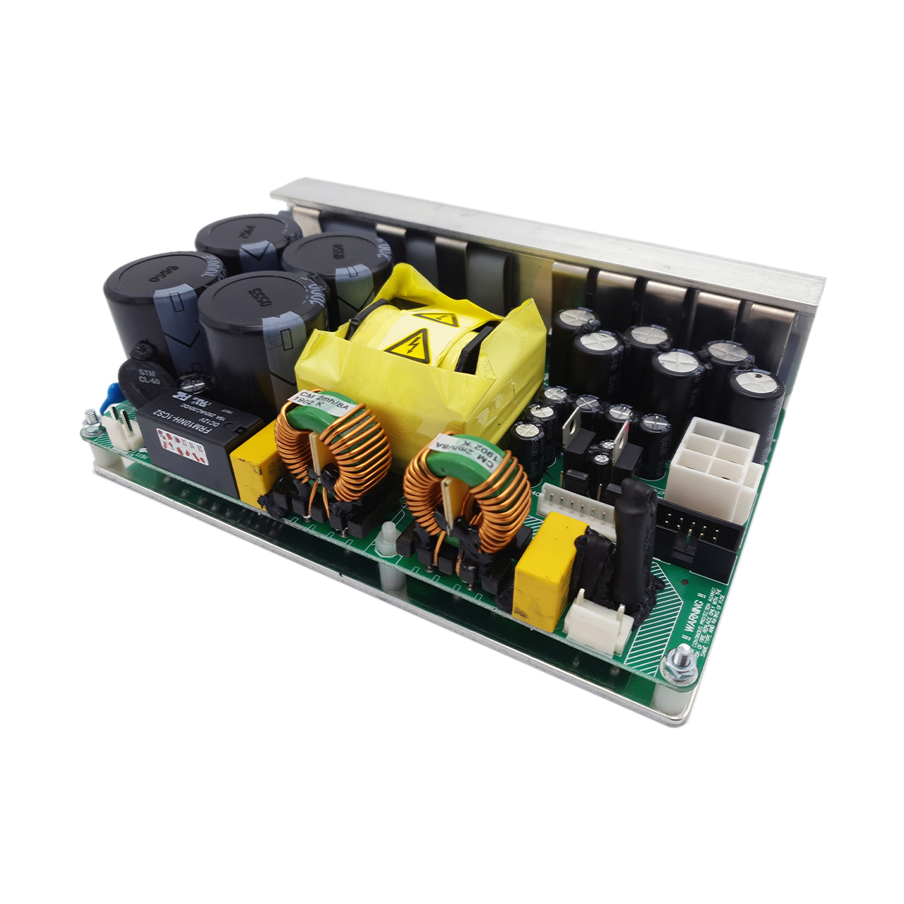

And I would need a Hypex SMPS1200 power supply
