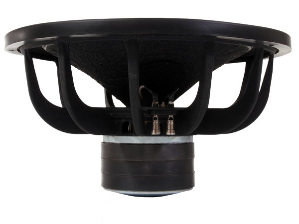

Is there any pics showing the difference between the drivers besides the dust caps?

Thank you Phillip. The new driver does look nicer,not radically nicer tho. Not like SVS,Rythmik,Velodyne,JL,or even HSU's. Those drivers look hard core!
I would not put the Hsu on the same level as some of the ones you mentioned...at least not he driver used in the 15H. After seeing picture's of it...it's NOT that imposing a unit...all credit must be given to Hsu and working some kind of magic.
Anyhow ...it's nice to see PSA going with the Eminence drivers...I think they use to make the drivers for Svs back in the early days when TV was at the helm....nice to see them reconnect. I look forward to seeing the data once JR tests these new units...I'm actually considering switching out the driver units on my XS30...:eek:
Not sure what you are looking at but the Lab15 looks far superior then any HSU driver except the ULS. I would probably put it close the ds1510 Rythmik driver.

I really like the looks of the SVS PB12/13u and Velodyne drivers. I mean the magnet and everything not just the cone. JL's also..
Driver isn't everything either. Just because the Hsu driver in the VTF-15 doesn't look like much, doesn't mean it won't give you excellent performance in its cabinet. You don't always need big beefy drivers as long as the cabinet and alignment are optimized for the driver or vice versa. TLSguys reference towers would probably give most people's sub/sat setups a serious run for their money/drubbing and he has no subs.
