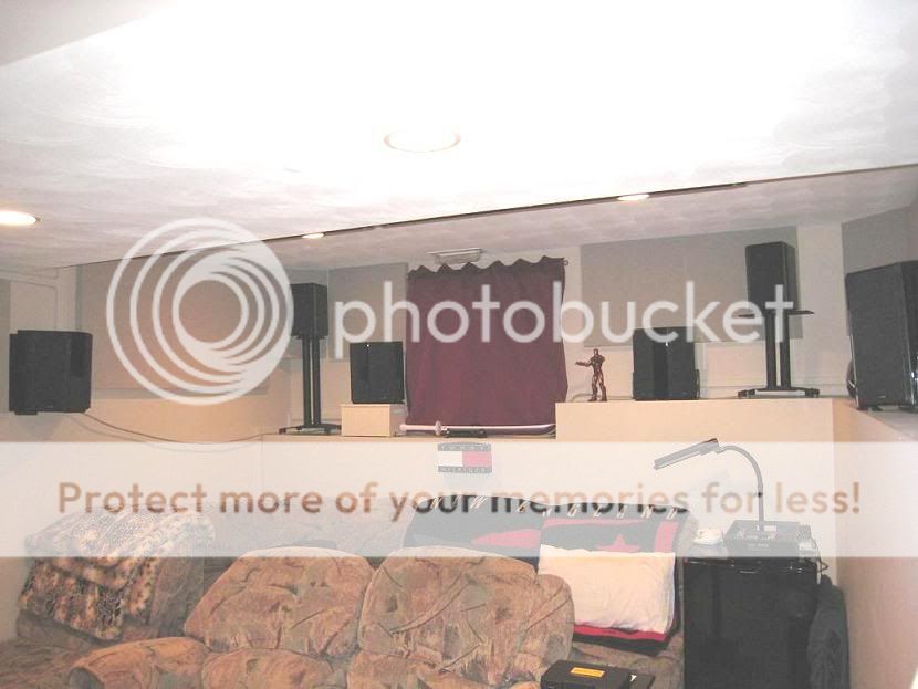

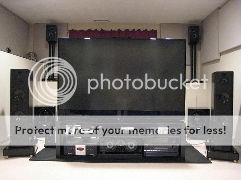

Setup
I included a few pics of the new setup. Don't mind the loose wires, I haven't yet put them back in the raceways. And the 2 front and 2 rear presence speakers aren't hooked up yet (I still haven't bought the Yamaha, yet). And no making fun of the couch. I want to replace it with theater seats, but one thing at a time....

Nice setup.
A few things you should check. Are you getting any sound out of the subwoofer. Does it have a standby/auto on feature? Is it turning on and off when the LED changes? You might want to look at the subwoofer pre-out setting in the receiver (what does this number read). The rubbish auto calibration could have set this much too low. An example is -12. In this case the sub might not be getting a strong enough signal to stay on and you would need to increase that number.
For the speaker, put the jumper back on the binding posts and make sure it is secure and not loose. How many drivers does that speaker have, does each one work?
