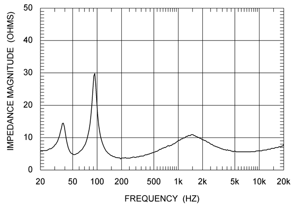

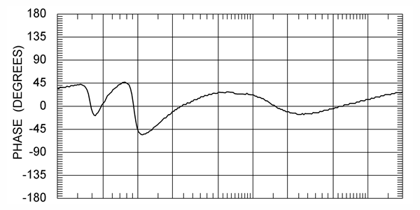

It is the phase angle between the applied voltage and the current drawn by the speakers. AC voltage and current are referred to as "phasors", (think vector on the mech side that most people understand). Phasors have magnitude and direction like vectors do, but the direction in this case is the "phase".
For a moving coil loudspeaker, both the magnitude (in ohms) and phase angle (in degrees or radians), would vary with frequency. Below are the impedance plots of the RTi A1 vs frequency.
Phase angle (in degrees):
and the magnitude in ohms:

S&V's review (https://www.soundandvision.com/content/polk-rti-a9-speaker-system-ht-labs-measures) showed the RTiA9's bass response from 40-300 Hz very flat, so if you are a bass head, the only thing you can do is to use them with subwoofers. REQ such as Audyssey (with the Editor App), YPAO, Dirac Live can also help.
The measurements did show some nasty phase angles at below 70 Hz, so again if you use sub(s) and set the crossover frequency to 80 Hz, you will take care that potential issue too, at least to a large extent if not totally.
Phase angle issues will result in more power/heat the amp's output devices must dissipate for the same current draw by the speakers. External fans may therefore be needed to help remove some heat.
