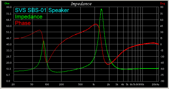

According to the review on Halon's speakers by Sound and Vision, their impedance goes down to 2.5 ohms at some point which might be too low for the SR6011 to handle. Unfortunately, SaV don't show any precision as to which frequencies the lowest impedance figures occur.
If it's in the lower frequencies range below 250 Hz, I think we would have the answer to his problems.
What say you?
Excellent point, in fact I did notice that earlier on but another source had the impedance much higher. If I can find that source I will post a link. For now, let's think in terms of logic, and consider the facts below for a moment.

Even at 2 ohm, he should get at least 85 dB when the amp is pushing 4WPC. The loss from being 9 ft way is likely offset by room gain and reinforcement from the other speakers. So if he listens at say even 75 dB average, the amp would be cruising at 0.4W average, less than 10WPC for 12 dB peaks commonly found in music. So you can see that his AVR is hardly the limiting factor. The example I used is quite extreme too. In reality, that 2.5 ohm dip even if true, will likely be taken care of by the subwoofer anyway.
Regardless, it is partially because of the concerns about the low impedance reported by one source, that I suggested he email the V.P. of SVS, who happens to be one of their engineer too. I generally trust engineers more than just anyone in the customer service department. Example, if I were to get an answer from Marantz, I would insist on getting it from their technical staff, not just anyone who answer the phone in the customer service department. I am sure Mr. Mullen know exactly how hard those speakers are to drive and probably has their impedance curves in archive.
By the way, I think people sometime worry too much about the impedance dips often found in small satellite speakers. Surely maths don't lie, lower impedance means higher current, but those tiny 2.5 ohm satellites can't handle much current anyway right? The bottom line is, they just aren't design to play loud and need help from a sub crossover at 150 Hz or higher. Halon's so called satellites are different, to me they may as well be bookshelves.

Hey Verdinut, as promised, here's the link to the other review that consider the SBS-01 8 ohms nominal.
http://hometheaterhifi.com/volume_12_4/svs-sbs-01-speaker-system-11-2005-part-1.html
http://hometheaterhifi.com/volume_12_4/svs-sbs-01-speaker-system-11-2005-part-3.html
"The impedance curve shows that the SBS-01 is nominally 8 ohms. The electrical phase stays primarily within ± 45 degrees."
Not that S&V had the SBS-01 listed at 2.5/4 ohm and the SCS-01 a little higher so it is a safe bet that the SCS-01(M) would have been considered 8 ohms nominal too.
Hopefully Halon will get the right number directly from their creator.
