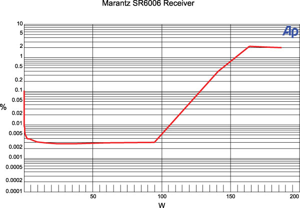

"This graph shows that the SR6006’s left channel, from CD input to speaker output with two channels driving 8-ohm loads, reaches 0.1 percent distortion at 127.9 watts and 1 percent distortion at 153.2 watts. Into 4 ohms, the amplifier reaches 0.1 percent distortion at 156.8 watts and 1 percent distortion at 195.8 watts.
Read more at http://www.soundandvision.com/conte...receiver-ht-labs-measures#KPEW2HSVW9t5bqse.99"
I think we can safely assume the 6011 is as powerful as the 6006, so there should be enough juice for your svs speakers in your relatively small room sitting 9 ft? from them.
