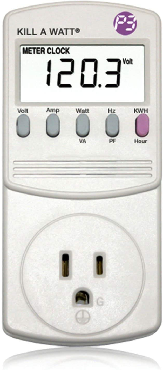

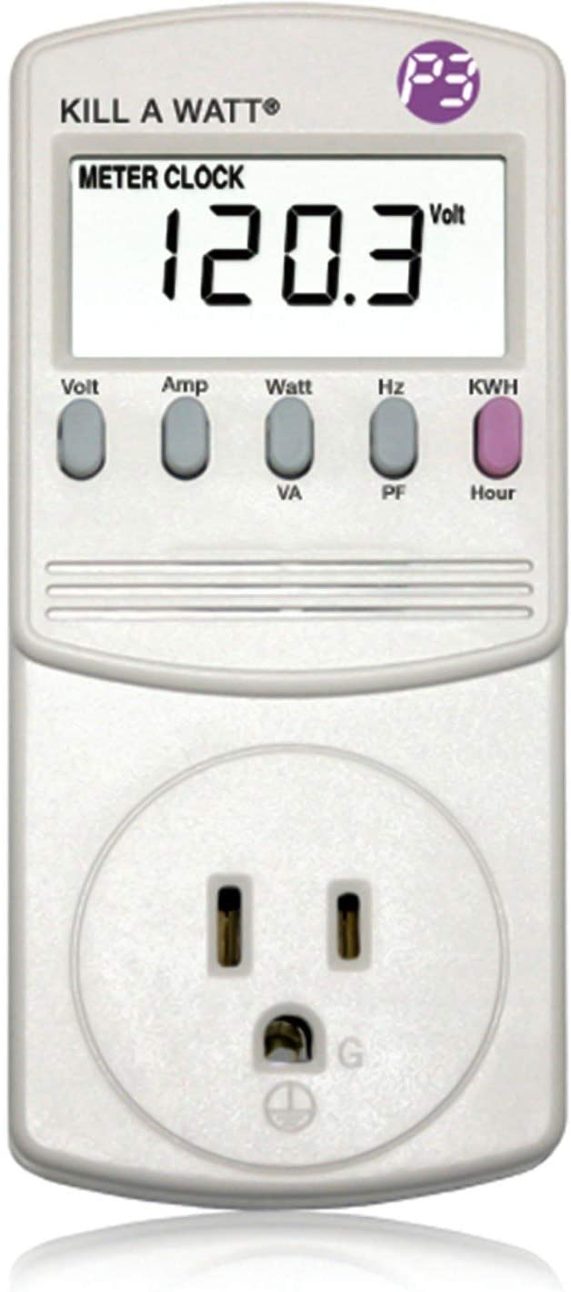

If you want to KNOW the power consumption of anything like this, buy a Kill A Watt- $30 and it shows current, Watts, KW-Hr and other details-

Thanks man! I did actually buy one and I have begun the sloooowwww process of checking each piece of equipment in the room.
