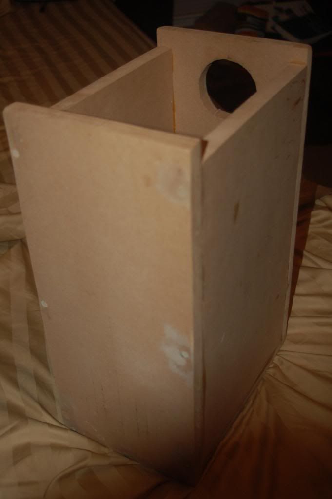

im sorry, i think that was my dyslexia kicking in there on my interior volume. its .56cuft not .65cuft. i believe that i have finally come up with my final dimensions...(ODs)
H: 17.5"
W: 7.5"
D: 11.5"
2.25" round port 6" deep for a port velocity of .08
port will be rear facing right behind the tweeter
tweeter will be changed to Vifa's BC25SG15-04 so i can achieve a smoother frequency band and an easier crossover point of 2khz.

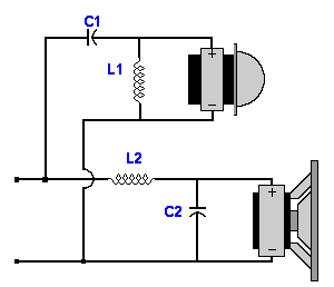

crossover will be 2nd order Butterworth as shown.
C1: 15uF
C2: 6.8uF
L1: .45mH
L2: .09mH
i hope i got it this time...:p

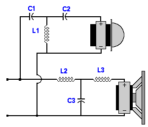

3rd order Butterworth
C1: 13.26uF
C2: 39.79uF
C3: 13.26uF
L1: .24mH
L2: .95mH
L3: .32mH
C1: 13.26uF
C2: 39.79uF
C3: 13.26uF
L1: .24mH
L2: .95mH
L3: .32mH

Here is your final design.
The pdf for you final box is attached.
The woofer is Peerless 164 WR 33 102 NWP AL LS 8 ohm.
This woofer has a smooth mid band response and a good off axis response. There is a break up mode peak maximal at 4.5 kHz. It is based between 3 kHz and 5 kHz. So this requires a crossover at in the region of 2 kHz.
In the specified enclosure the F3 is 49 Hz. The tuning peaks of impedance are 33 Ohms at 28 Hz and 34 ohms 80 Hz, which gives a null of impedance of 8 ohms at the F3 of 49 Hz, showing optimal tuning of the design.
Vb is 0.56 cu.ft. The port is flared at both ends and 2.5" in diameter and 9.738" long. Vent velocity at max power is 24 m/sec.
The vent and driver displacement is 0.0618 cu.ft. This needs to be added to Vb as well as brace volume and crossover volume. The sum of these will be Vt which is the actual size of the box you need to build.
50% of the internal surface should be covered with damping material such as mineral wool. Areas behind the driver should be covered preferentially. The volume of the damping material is allowed for in the design.
The enclosure should be well braced and as narrow as possible. The tweeter should be as close to the top as possible, the woofer below the tweeter as close as possible. The port should optimally be placed below the woofer. I prefer the front, but rear mounting is also satisfactory. Drivers and port flare should be flush mounted.
To minimize diffraction effects, the corners should be rounded like this.
The tweeter is the Vifa BC25SG19-04.
This tweeter has a very smooth response over most of its pass band. There is gradual attenuation above 9 kHz which becomes steep around 18 kHz. This is not a bad fault in a tweeter for a small bookshelf speaker, and actually tends to give a better bass/HF balance. I have made no attempt to pull up the response.
Fs is 1060 Hz. So the tweeter should optimally be down 24 Hz at that frequency.
The crossover is centered at 2 kHz. The low pass filter has an electrical third order slope. The HF filter has a second order electrical slope. The combined acoustic and electrical slopes give fourth order slopes, with the woofer being 24 db down at 4 kHz and the tweeter 24 db down at 1 kHz.
There is also diffraction compensation. Because of power limitations, loss of sensitivity and lowering of impedance, 4.5 db of diffraction loss compensation is provided rather than the calculated 6 db. However room gain will almost certainly correct this. The curves shows a rising low end response, but because of diffraction loss the response will almost certainly be flat to within 3 db from 49 Hz to 9 kHz.
The crossover pdf is also attached. L2, L3 and C2 form the third order low pass filter. The values have been tweaked to provide 4.5 db of diffraction loss compensation. Req and Ce form a zobel to correct the woofer frequency dependent impedance rise so that the low pass filter can work as intended.
C1 and L1 form the second order high pass filter. Rp1 and Rp2 form an L-pad to match the tweeter output to the woofer.
All inductors should be good quality air core. The capacitors should be good quality Polypropylene. Resistors should be wire wound 10 watt minimum.
After diffraction compensation and insertion loss of the crossover, sensitivity will be in the range of 84 to 85 db 2.83 volt 1 meter. This is fairly typical for a small bookshelf speakers.
The crossover models as a superior crossover. In addition to a nice flat mid band response, the impedance curve is very flat indicating an easy to drive speaker. X-over pro assumes a sealed alignment so the tuning region impedance curve will be the one in the enclosure pdl. Impedance is 5 ohm over a good deal of the frequency spectrum. I would give this speaker a 6 ohm nominal impedance rating.
The phase response is superior. Tweeter and woofer are only 45 degrees apart at crossover. This is an excellent result.
The speaker if built correctly should have a an accurate smooth response and wide sound stage. Hopefully they will sound bigger than their size, and be pleasing to listen to even without a subwoofer.
Good luck with your build. Take your time and build it carefully.
Please keep us informed as to the progress of your build and the final result.

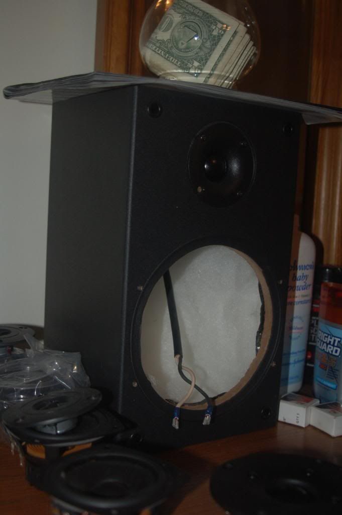

Thanks, but I'm kind of confused- I'm not using the Nomex cone woofers, I'm using the Vifa BC25SG15-04 tweeter and two of the 830874 woofers. I know the NASP is crossed over at 3KHz but I was thinking of 2700- any reason to choose one over the other? The Fs of the BC25SG15-04 is 1000Hz.
The photo shows the driver arrangement.

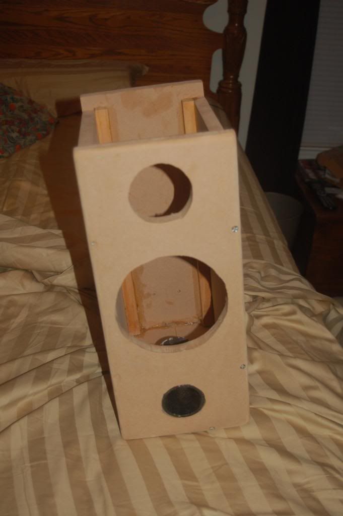

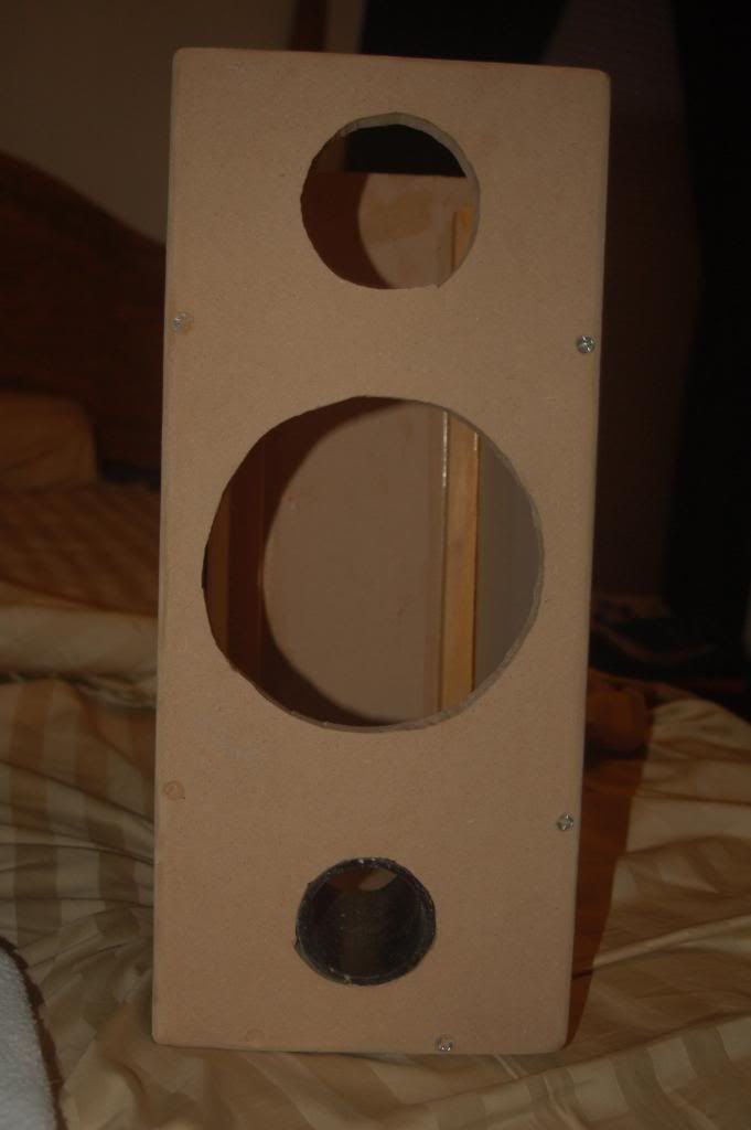

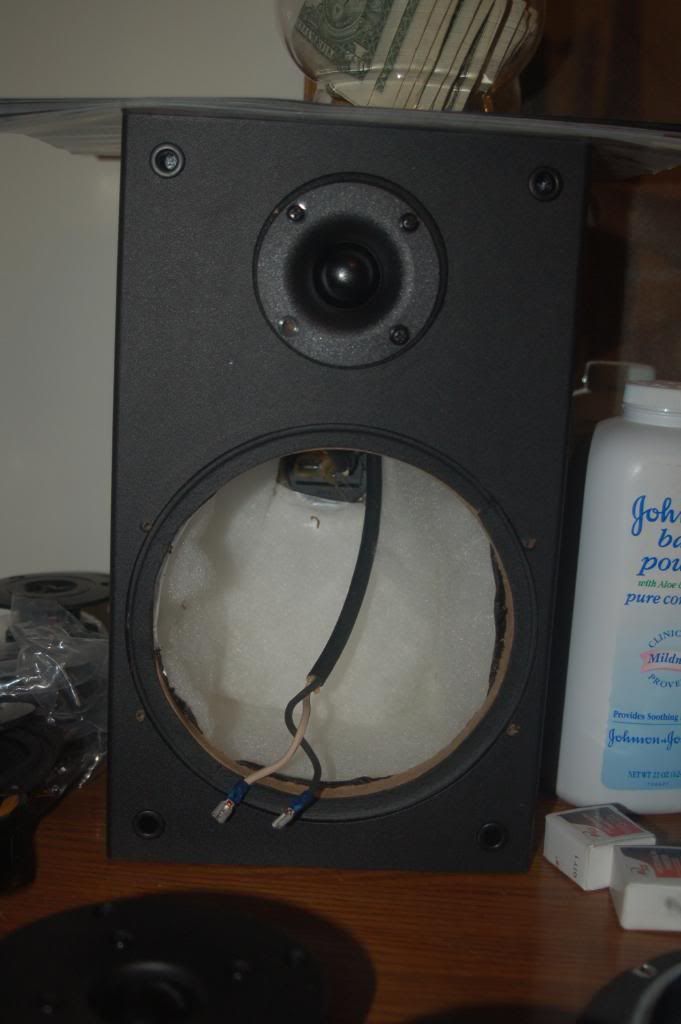

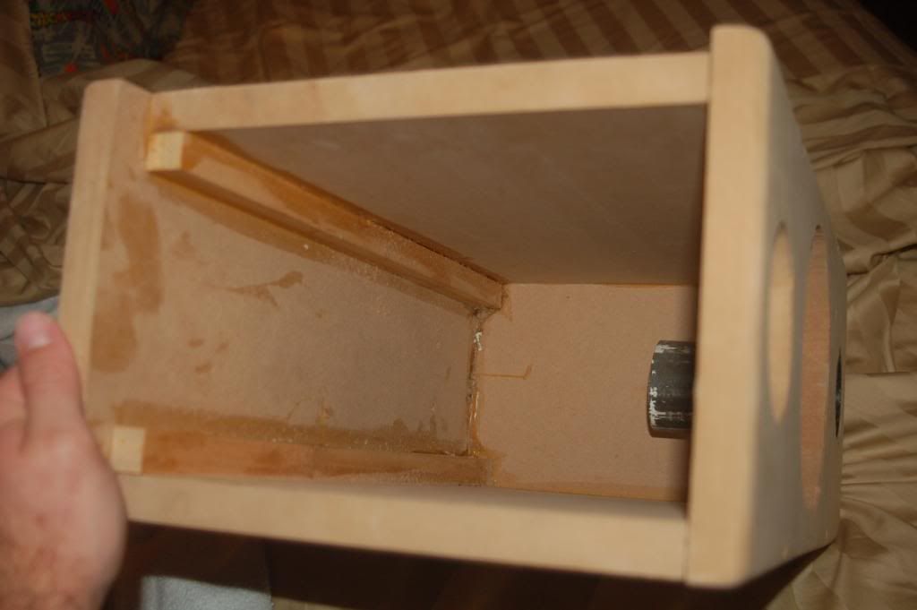

progress thus far...
the black box is what they were in...big difference eh? i know the holes are far from perfect but i think itll suffice for my first project. until my crossover components come in, this is where i stand. im going to wood puddy the seams and screws for a nice smooth finish and give it a coat of midnight blue. i have a hard wood that i will stain for the front baffle. still contiplating on the design. what do you guys think?
annunaki
annunaki
Moderator
I think that it is great that you started a project and are getting into the DIY area! :)
If you would have went with a slot vent you could have avoided any rough cuts around the port openings as you can make easy straight cuts.
Here is an example of what I mean:
http://forums.audioholics.com/forums/showthread.php?t=61012
If I were doing this over again I would have done things a little different but it should give you some idea of what I mean.
progress thus far.the black box is what they were in...big difference eh? i know the holes are far from perfect but i think itll suffice for my first project. until my crossover components come in, this is where i stand. im going to wood puddy the seams and screws for a nice smooth finish and give it a coat of midnight blue. i have a hard wood that i will stain for the front baffle. still contiplating on the design. what do you guys think?
Don't be stingy with the screws- The corners each need one and I usually put one every 4". If you tap on the side where you're putting them, you'll hear the note go up as you add screws and this is putting the cabinet resonance above anything that will be excited by the woofer's frequencies.
