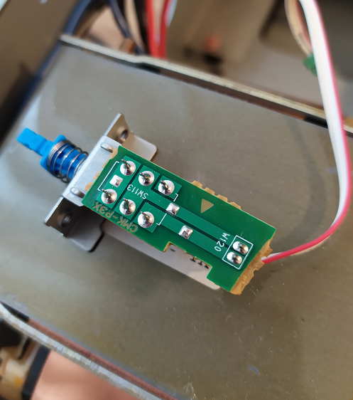

I'll skip right to the point. I need to desolder this and change it. I have a feeling when I get to no. 6 the first will cool down and solidify again. Do I need some special soldering iron or is this a non issue? Solder forms in droplets and tends to get removed entirely when it moves from a spot.

Thank you high. I doubt it's that. It doesn't stay on after being pressed. Meaning it turns on the amp, no problem, but doesn't self-lock in that position. I think the route got worn.
No problem with contact. And it'll stay on as long as you hold it pressed, but once you release, in stead of staying locked in on position it goes back to off.
The reason I don't like this, other than thee pure fact it's broken. Is because when you want to turn it on, you have to do it 5-6 times before it stays in the on position. This means you keep powering on and off the circuitry and I don't want to make something give in.

I had a switch pretty much identical to that give trouble a few months back.
Anyhow the best assist is a soldering clamp like this.
It is best if you can support what you need to repair.
Now I use a desoldering iron, but you don't need one, it just makes it easier.
Get the solder joints hot, one at a time. When the solder flows, just pull the wires out with pliers. If the hole fill with solder, then use a little piece of solid copper wire, heat the solder in the hole and poke it though with the copper wire. Keep the wire moving to and fro until the solder cools. Then you will have a nice clean hole.
Now tin the wires you will solder back, not too much. Poke the wire through the hole, and then let the solder flow. Make sure you use enough heat that the solder flows freely otherwise you will get a dry joint. Make sure that you do not use excess solder and create a solder bridge between the joints.
It is not difficult.

It looks like it won't be a 'plated through hole' PCB in which case, solder wick or a solder sucker as mentioned above will be perfect, and you can take your time. If it's a plated through hole PCB, it's a little more difficult - the pins need moving sometimes, at the same time as heating the joint, to break the pin away from the walls within the hole. I hope this helps.
Well, I'll have to gear up at least a bit. I don't have any of these.
You don't need a desoldering gun or suction. My trick with the solid copper wire and keep it moving will do the trick just fine, to restore the hole open and free of solder.
You must understand though, having a 'third hand' of some type is important. It is crucial to keep what you are working on perfectly still.

For 3 years of my military service, I worked in the lab repairing laser and night vision equipment. Soldering boards and connectors were not something you'd do once a blue moon, but several times a day.
So sure, you could use copper braid of sorts, but it's much easier and cleaner results with a pump.
I do agree with Mark on having small vice or clips to hold your board to have free hands is pretty much a must to have. something like this gadget:
