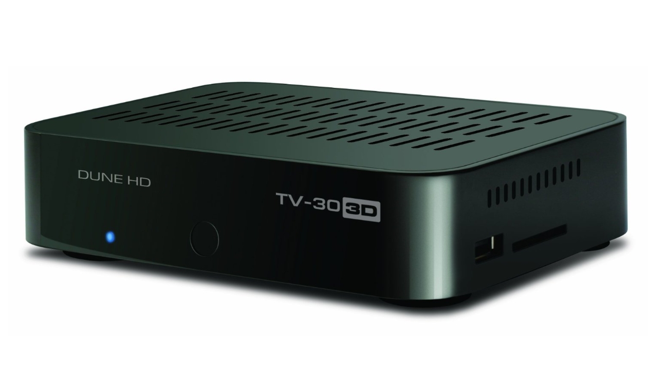

Martin_320
@TLS Guy and @TweakerInWA: No don't convert them to MKVs!
Save yourself a lot of trouble and play your multichannel flac files through a Dune HD into your HDMI receiver and you'll fine.
Search on Amazon for the Dune HD TV-303D (this is the most recent version -- I have one of these so I know it works).
Ps. I have hundreds of 24bit 5.1 multichannel flacs on a NAS with sample rates up to 192kHz. Been playing them bit-for-bit perfect from the NAS through my Dunes and out via HDMI into my Onkyo receiver for the past 4-5 years!
