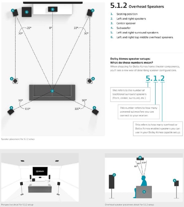

So I should do 5.1.2 instead of 7.1? What if the movie doesn't have atmos? Do the height speakers still work? Placement for the 5.1.2 height speakers would be from the ceiling pointing down straight at the listening position? How far in front of my listening position? And should I point them right at the LP?

Yes start with the top front, then top rear. There won’t be a center rear. Atmos speakers are only added in pairs. Ie: front height/top front/top middle/top rear/rear height.
The front side vs height you’re talking about is old school pliiz/height or wide. Not the same as Atmos height/wide.
There is support for Atmos plus wides but discrete content is very small. Dsu doesn’t use wides either so not much point for normal Atmos installs.
Yep. 5.1.2.
If the movie doesn’t have Atmos, just use dsu(Dolby Surround Upmixer), then they’ll work when called for.
I would probably point them at the LP, depending on how many seats.
:eek: I failed my lingo test!
But cool, first two pairs are Top Center, then Top Rear, aimed toward LP.
