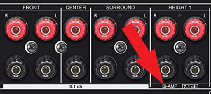

Hey John - Good to see you buddy!
Yes, the Pioneer does support bi-amping. Check it out:
Worth it to experiment...

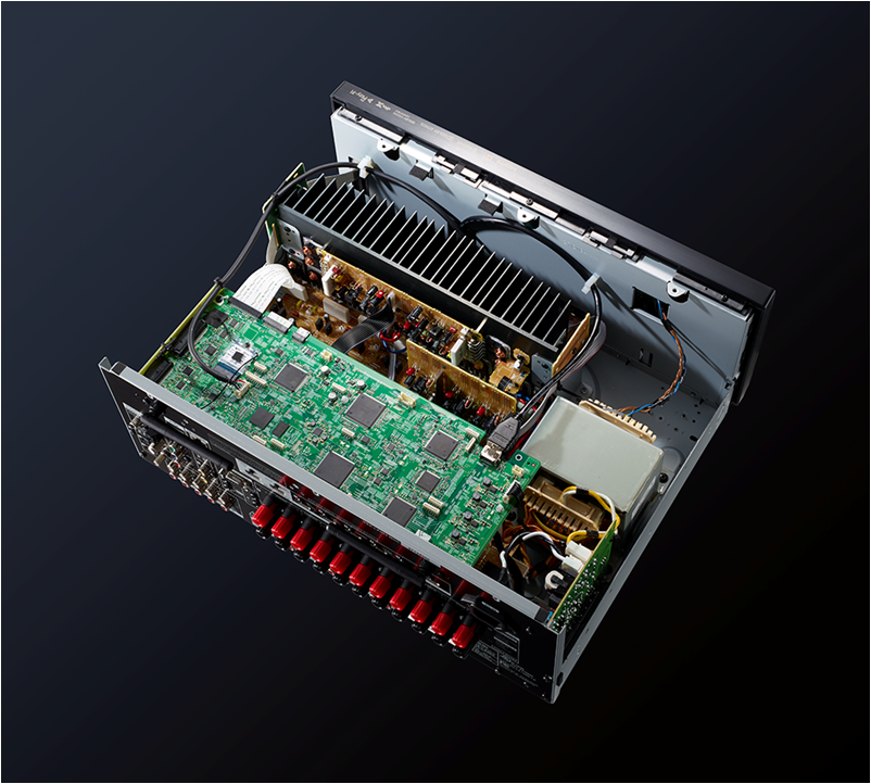

PENG
I don't know anything about this what they called "direct energy" amplifier. I thought it was some sort of class D because Pioneer appeared to be getting good at those, but looking at the weight of the unit and size of the power supply, it looks more like the typical linear PS for class AB amps. May be the term "Direct energy" was invented by some marketing genius at Pioneer.:D
I prefer Yamaha's, but then again I don't know anything about the direct energy thing so probably should not have commented at all.

This avr cannot actively bi-amp (your speakers particularly, of course it can offer a bi-amp between your sub/speaker), and the passive bi-amping it offers for speakers....meh.
John Parks
John Parks

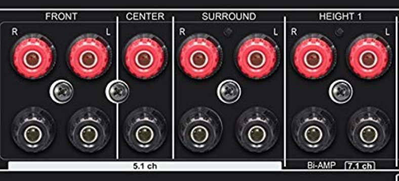

So, does this not count as "active" as in a separate, amplified channel?
The owner's manual shows that the "Height 1" outputs can be designated as a "Bi-Amp" channel. IS that passive or active? I was hoping it would be another 120WPC...
No,, it does not double power. Plus that's a passive bi-amping feature in the avr; more about marketing for all the similarly marketed speakers with the bi-wiring terminals. Active bi-amping involves separate amps and active crossover (rather than the passive crossover you leave in your speaker with passive bi-amping; altho you can remove the passive network for active bi-amping it's still a matter of any actual improvement over the original design). With a single power supply an avr's passive bi-amping is pretty much useless IMO.....consensus is if you need a more powerful amp simply use one (does your avr have pre-outs?). Might want to review this article https://www.audioholics.com/frequent-questions/the-difference-between-biamping-vs-biwiring

Hey lovin - thanks for the response and the link. Yes, I am familiar with bi-wiring, bi-amping (passive and active, vertical and horizontal) etc., yes this AV receiver has preamp outputs and no, this is not my AV receiver (yet) hence my questions. I guess I used "active" improperly in that my question was not to include active crossovers. If the "Bi-Amp" feature does not indeed increase the power by utilizing another channel, then you are right - it is pretty useless. I also found more of the "marketing" poop in that this receiver is rated at 120WPC - 2 channels driven (which is fine by me as I will only be using the 2). Power drops to 90WPC if all nine channels are driven. No huge deal, but not reflected in the official specs and it also tells me the amplifier channels are not discreet (whether that is audible or not...).
:D
PENG - you are absolutely correct! After more research this weekend, I found out that this unit is indeed class AB, which is fine by me. Pioneer still refers to the amplification as "Direct Energy" - whatever that means... Anyway, my aversion to Class D is a non-issue with this receiver and it now sits at the top of my list.
