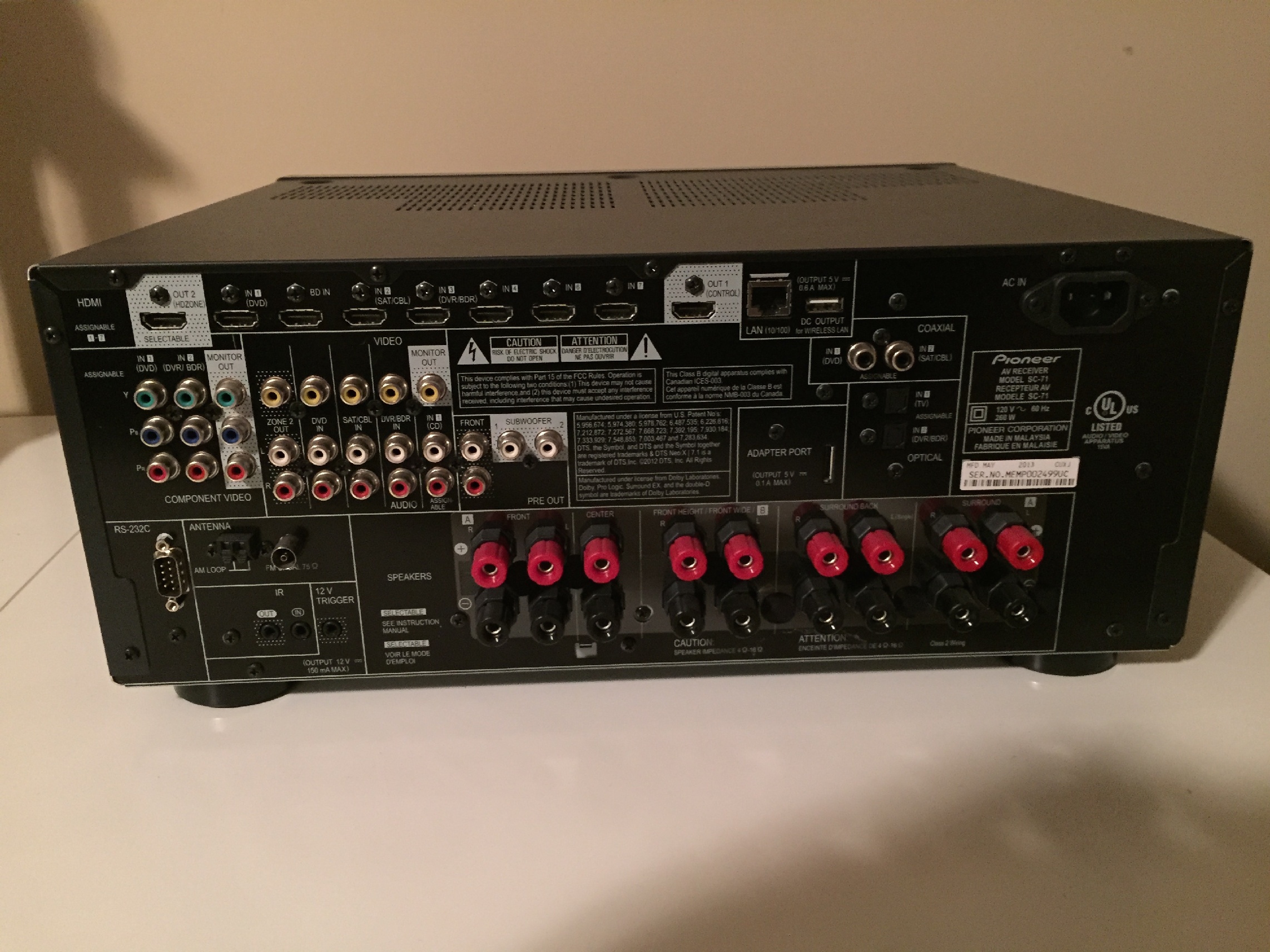

This is the back of my receiver. Why is there a HDMI output for zone 2 if there's no digital? There are RCA outputs as well. Things I have plugged in are a WiFi audio cast and fire stick.
This is the back of my receiver. Why is there a HDMI output for zone 2 if there's no digital? There are RCA outputs as well. Things I have plugged in are a WiFi audio cast and fire stick.View attachment 29269
I'm not so sure that is a "Zone 2" HDMI output.
What I see says "Out2" and "selectable".
I'm agreeing with the other folks, your AVR likely will ONLY output ANALOG to Zone 2.

Last night I sat behind the receiver and tried hooking up the projector (InFocus IN3106) again. I tried an HDMI cable from the OUT 2 (HD ZONE) but couldn't select HD ZONE on the remote. so that got me nowhere. then I tried RCA cables from Zone 2 RCA out to the projector and got the receiver menu (video) but nothing else. it wouldn't recognize the firestick or the cable box.
Yeah, at this point, all the evidence suggests: "Analog ONLY on Zone 2 out". And, by my experience, very few AVRs will output a digital signal to Zone2.
So, what you are trying to do likely won't work due to hardware limitations.
