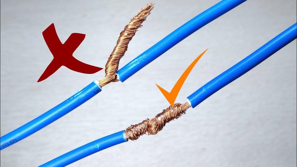

Yep. You can definitely do that. I personally like butt connectors but a good twist works too. Just make sure you do it like this.

Definitely,100% no prob. I took electrical classes in high school. I would never do that too photo ever. Thanks again.
While that is a more secure mechanical connection, does this method provide any better conductivity in the splice? Is there any data on this? Most electricians just twist and wire nut electrical cables together, and I've not heard any data on actual differences, but would be interested in knowing.

I can’t say that there is any real data about conductivity, other than my imagination lol. Although there was a video that I pulled picture from since I didn’t think I could describe it via text. It might cover some of that. I just personally like doing it that way as IMO it’s just cleaner, and if it’s a solder joint it’s easier to do, and looks and holds better. As far as electricians, they’re usually dealing with solid wire and ime it can tolerate the abuse and conditions better. I’ve never done any tensile strength testing either though lol.
Anyways, no I don’t have any science. Maybe I shouldn’t have said make sure you do it like this, and instead said that’s how I like to do it.
No difference in conductivity. Any difference due to the physical break in the wiring is insignificant so it's treated as a single strand. Main benefit is that the lower image will not easily come apart under tension. It's really only when you get into the gigahertz band that these things become a factor.
