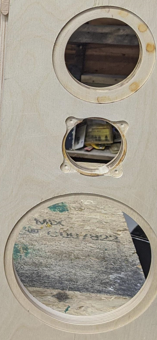

That cutout for the midrange looks choppy from the photo, is that after working on it?
I don't know.
I only wanted to illustrate what the recessed cut out looks like for the mid-range. It's why people are interested in the flat-pack cabinet, even if they have a router and can cut circular recessed cut outs.

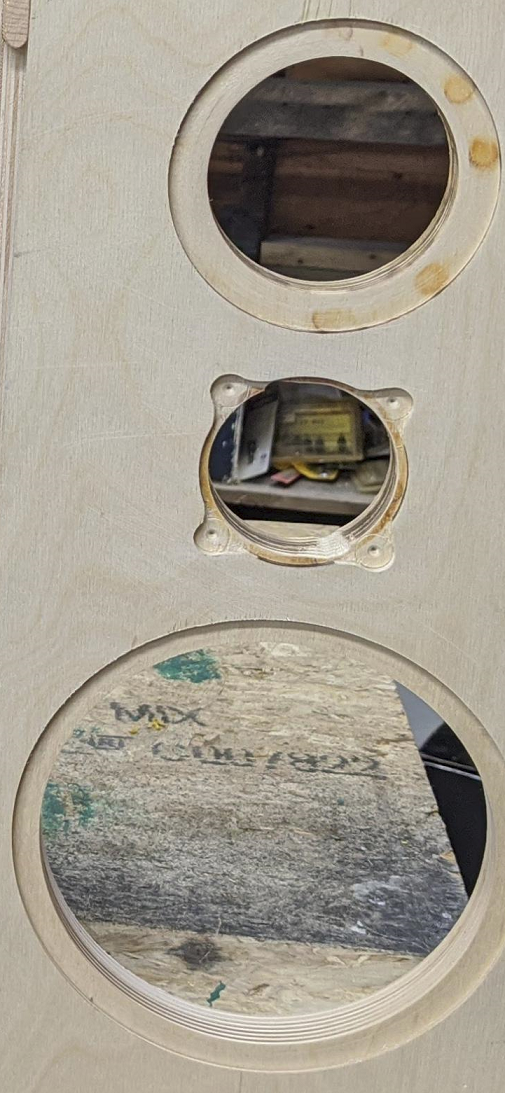

Here's another photo I found online.

That looks like the screw-down "wings' were drilled with a Forstner bit and their fillets chiselled out after the initial hole was cut with the router.
Possibly. See my edit in post #110. I just found another photo with less resolution, from the supplier of the flat pack kit, Speaker Hardware. It looks like it was done with a router template.

I would absolutely expect that Leland is using a CNC… and if not that he is using a jig/template.
That first photo was definitely a rough job! ;)
Alough a CNC is nice, this job doesn't require one of those very expensive tools. A router, a ¼" spiral upcut bit, and a ¾" template bushing collar can get the job done.
A number of years ago, I stumbled across a web site that explained how it's done. See the attached PDF. I've done it once, a number of years ago. It worked the first time I tried it, so it's fairly simple.
