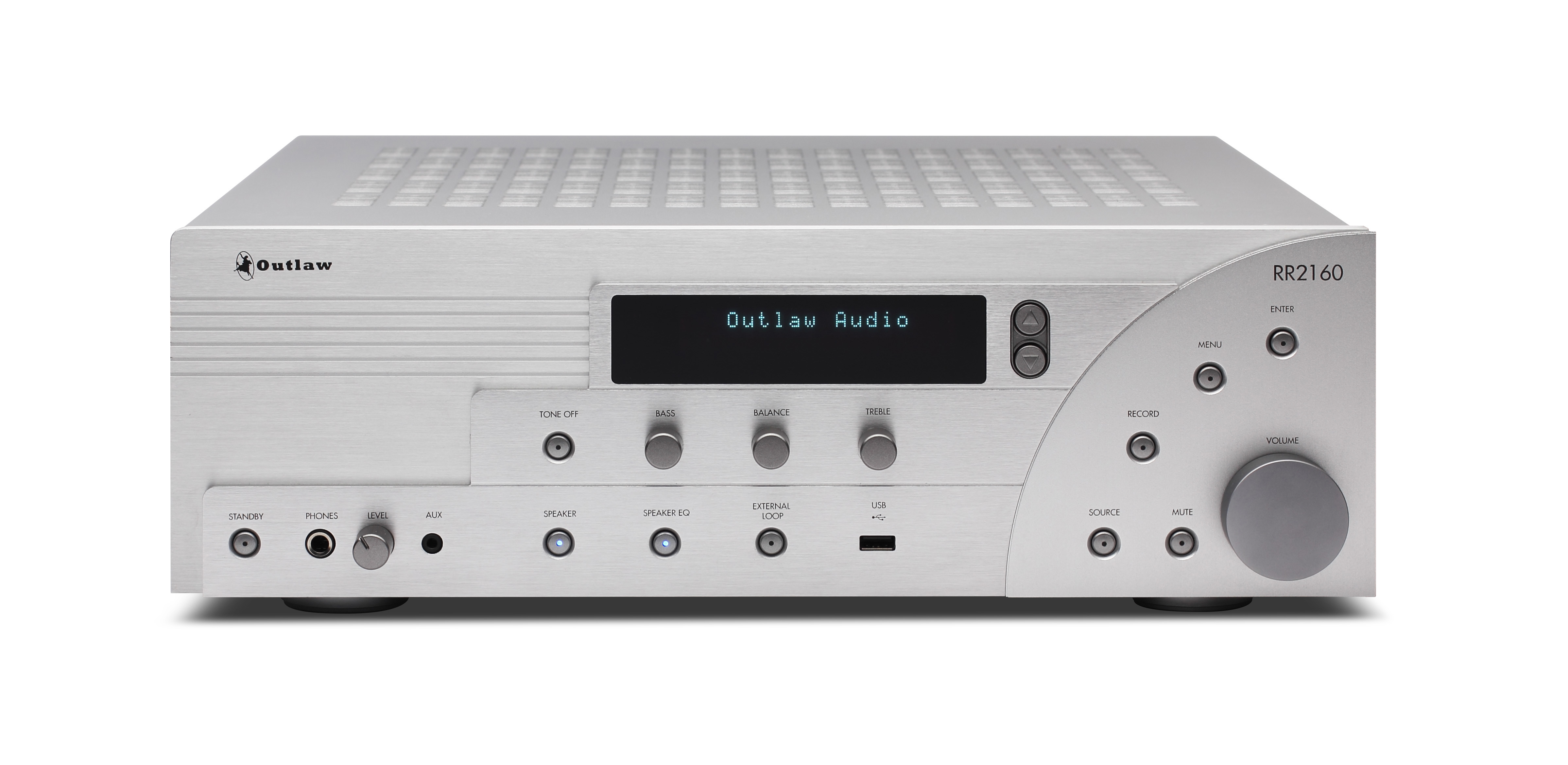

In general, if you only want stereo and If you can stomach a built in tuner, I would Save some money and get the Outlaw RR2160. If you research it, you will see that this really is an integrated amp with tuner as compared to most stereo receivers.
https://www.outlawaudio.com/products/rr2160.html?gclid=EAIaIQobChMIhdWUr-zK1gIVlbjACh3kYwcCEAQYASABEgJNhfD_BwE
http://hometheaterhifi.com/reviews/receiver-processor/receivers/outlaw-audio-rr2160-stereo-retro-receiver-review/

In comparison, the Outlaw:
Continuous Average Power:
110 watts per channel, 20 Hz - 20kHz,<0.05% THD, both channels driven into 8 ohms
165 watts per channel, 20 Hz - 20kHz,<0.05% THD, both channels driven into 4 ohms
All that said, the NuPrime would probably work fine for your situation (assuming you have checked it for the inputs you want/need). It just seems like a poor value.

In case you did not notice, the Outlaw does have an integrated DAC.

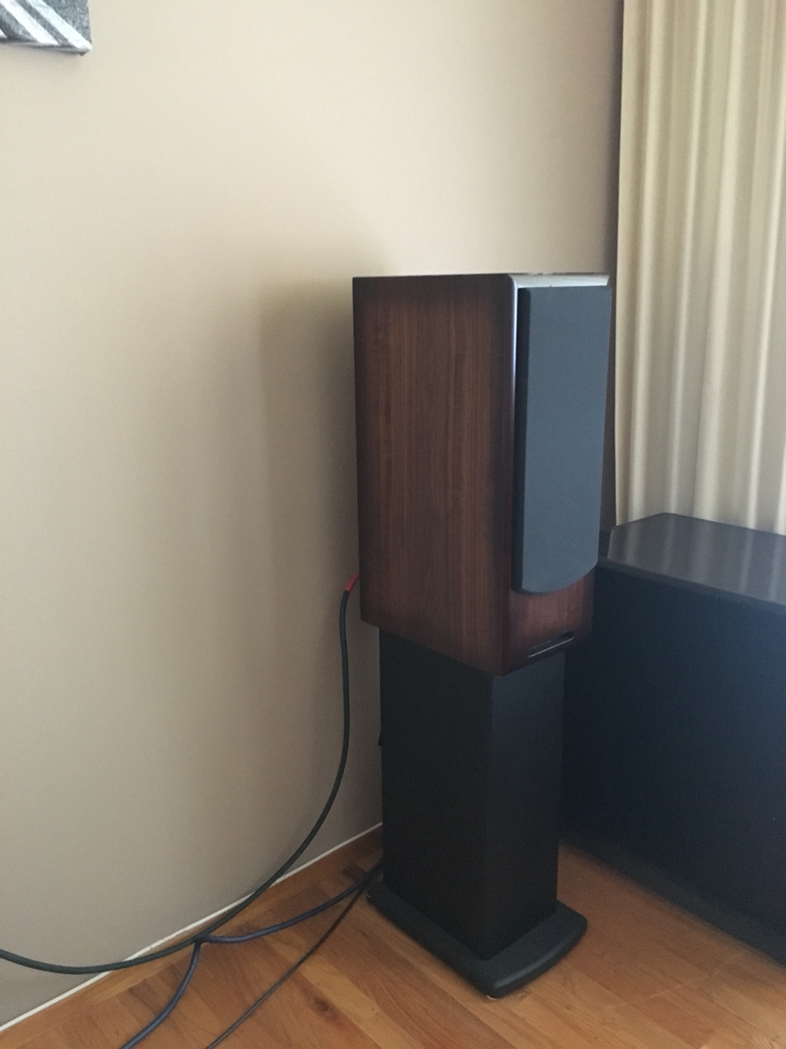

Just curious, any chance these BMR would work well and look nice on those Ascend stands--the ones that make his BS speakers look like tower speakers?
I can attest that they work very well.
As for appearance, judge for yourself. (Note: my BMRs are a bit taller than the review models. They are in Salk cabinets with slotted front-facing ports.)

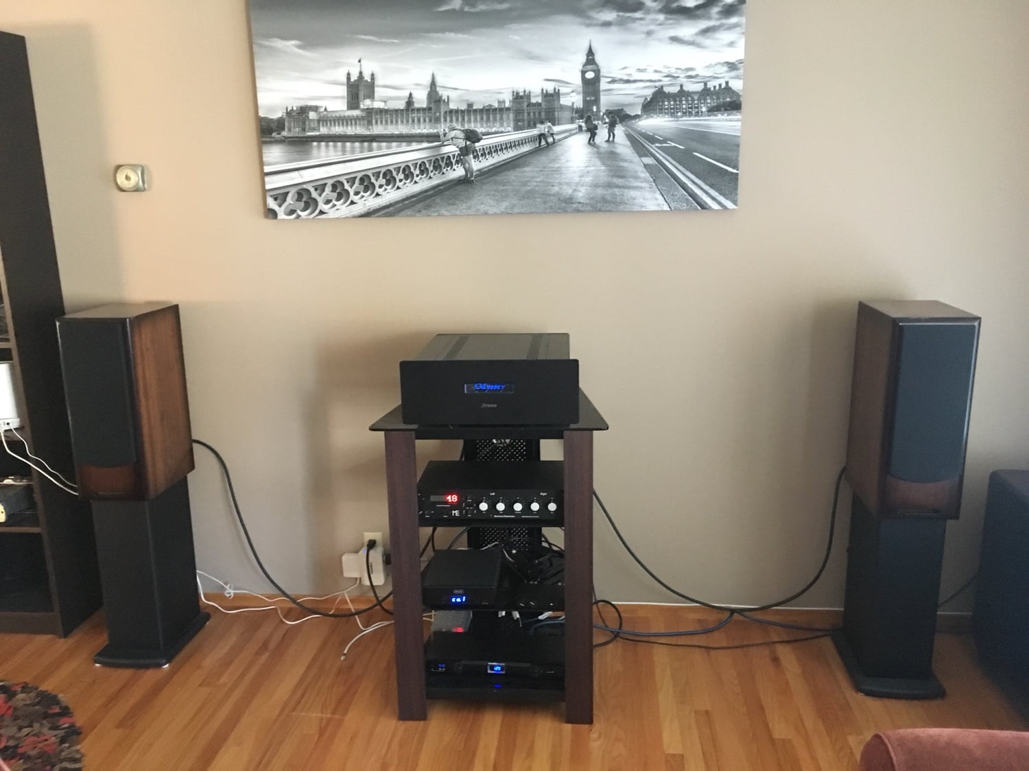

I am driving my BMRs with an Odyssey Stratos Plus Stereo power amp. It sounds fantastic, but admittedly overkill for your situation (I have a large living room, and I’m a big believer in having lots of extra headroom). That said, the Odyssey Cyclops integrated amp might be just the ticket for you @ $1100.
