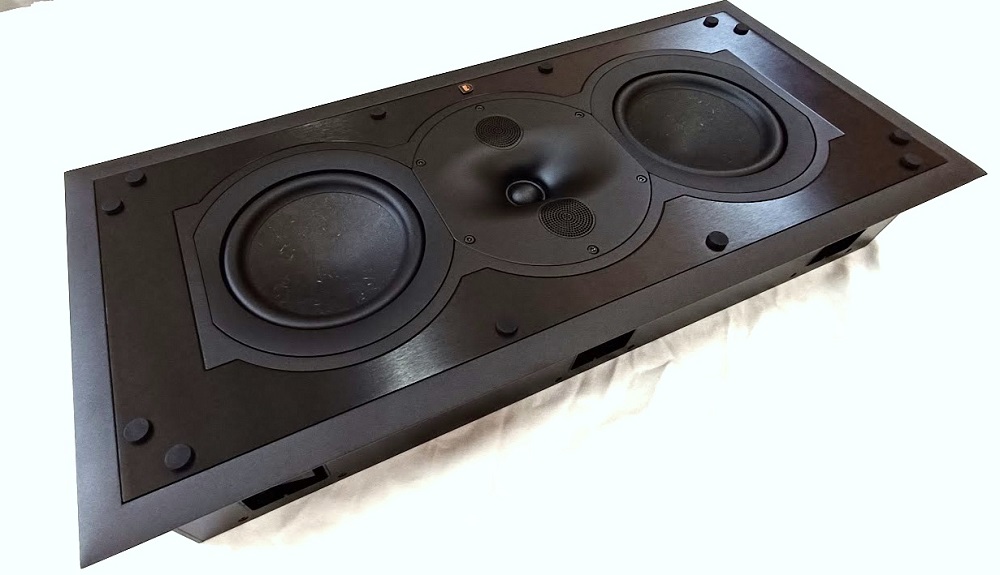

It’s hard to believe that just two years ago, we’d never even heard of Perlisten Audio. It’s fair to say that the company has taken the world of high-end audio by storm. I can’t think of any competitor that has achieved so much so quickly after its initial product launch. And while some new loudspeaker companies come to market with a single design, Perlisten burst through the gates with a whole line of speakers and subwoofers that compared favorably with the best of the best. Perlisten’s speakers and subs have earned the highest respect from the two-channel Hi-Fi crowd and from the high-performance home theater crowd. The next step, it would seem, is the world of custom-installed home theater and discreet in-wall audio. At CEDIA 2022, Perlisten showed off not one, but two lines of in-wall speakers, mirroring its S-Series and R-Series of freestanding speakers. The new S-Series and R-Series in-wall speakers utilize the same advanced technologies as their in-room counterparts, promising perfect timbre-matching across the whole Perlisten product line. Read our in-depth preview to find out more about Perlisten's Signature and Reference series in-wall speakers...
