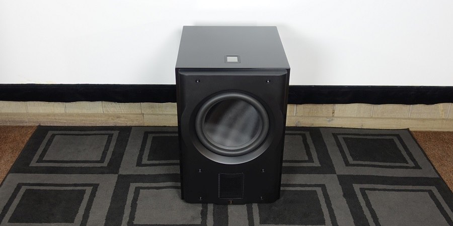

As to finish/looks of these subs....a big meh as to most WAF acceptance I'd think just on size, the finish doesn't look that great to conquer that aspect.
Well, considering the fact that cosmetics have no effect on performance but large effect on price, I'm sure more WAF resistance would come from an additional $500-$1000, depending on what is used to make it pretty and the techniques needed.
