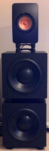

I have a modest, finished basement and 4 Rythmik 12" servo subs in it where I use them as speaker stands for the front L/R speakers. There's enough space to easily add 4 more subs in the rear. 4 subs, though, are enough to cause the concrete floor to vibrate while still playing very cleanly.
As to the weight issue, each of these Rythmik subs weighs in around 55 lbs. All together, they weigh just a hair more than the Perlisten sub. When I need to move them, I don't mind that.
