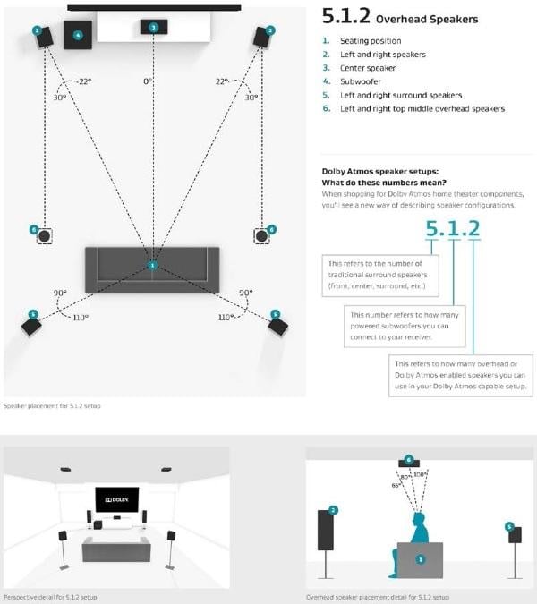

I am wondering why Yamah TSR-700 manual recommends this for 5.1.2 for atmos (see attachment)
The manuals are a good starting point but they are not 100% accurate. A lot of us with atmos systems can help you navigate that. As @witchdoctor posted its all about the angles and getting those right.

The manual shows the "presence" speakers in either front height or top middle position, so either can work but members would like to see photos of the room to make a recommendation. Yes, the Prime Elevation are good but the JBL Control X linked to above are a good deal. If this is just for movie effects you can be a little less concerned about sound quality, but if you are into multi-channel music then you might want to consider spending more. While I'm not a fan of B&W towers, I have heard the AM-1 outdoor speaker used indoors and they are quite good (but expensive). You might be able to find some used, but for $200 those JBLs should do the job and at that price you could always swap them out later (especially if you catch them on sale). The RSL ceiling speakers are quite popular but you'll need to build boxes (and add some poly-fill). Personally, I think that $1,000 for ATMOS speakers is overkill, so I would either start with the JBLs or go with Polk or Klipsch or SVS angled speakers, depending upon what speakers you have now and your budget.
