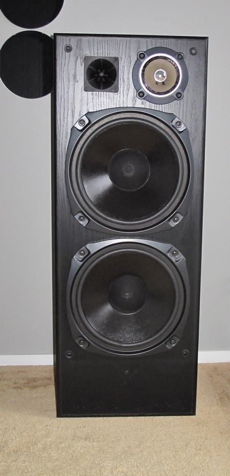

So I've done a bit of work on these speakers. First off, I've put back the original mid-range driver. The reason it sounded muddy & unclear is because it was fading out intermittently. The Italian made Faital Pro replacement mid-range was too efficient (97db @ 1 meter) for the other drivers and it was over-powering on certain music genres, so I had a look at the original mid-range and repaired the short. Sounds fine now. It is a bright & crisp mid and is now properly balanced with regards to the other drivers.
I managed to get my hands on another woofer produced by JVC, it was actually in a Pioneer speaker. Got these all Japanese made woofers for nothing. So I pulled the JVC passive radiator and mounted the second 12" woofer in parallel. Overall speaker impedance dropped from 8 ohms to between 4 & 6 ohms, still fine for my amp. I also replaced the tweeter a few times with a Jensen, JBL, an old Tannoy and an AR tweeter - all were very good but their volume was too low on account of their low efficiency rating. So I chose this 105db @ 1 meter Piezo tweeter. My top-end hearing isn't what it used to be, so this one worked out much better. I field tested them with jazz, some classical, hip-hop, house, Paul Oakenfold techno and some 80s rock. They handled them all no probs.
These Franken-speakers are now the perfect speakers for my den. Mid-range is smooth and not peaky, mid definition is good too - but not as good as the Faital Pro mid. May hunt for another mid going forward. Highs are dynamic & crisp without being harsh. Harsh is always something I'm trying to avoid. The previous JVC tweeters sounded boxy and closed, these new tweeters are open and much less directional - speakers sound similar when I walk around the room.
Not sure what I've made these into, whether they are still semi-passive rad or are now semi-sealed is tough to say - there is no port and certainly no lack of bass. The math says there is enough volume in the cabinet to support a sealed or semi-sealed design, but my ears were the final verdict. I'm glad I ignored the math and just used my ears. The whole idea of this was to get that bass I was after, modern designs w/ 6/5" woofers just don't do it for me unless there's a sub attached and I didn't want that in this application. They now have excellent bass, much smoother and more well rounded on the bottom end, nothing quite like dual 12" woofers. I feel the extra sound dispersion is from just having 2 extra drivers to produce more sound projection, so more bass, more perceived volume.
Just in case I was polishing a turd, I invited a couple of audio snobs over and after a good laugh at my creation, they enjoyed the sound and especially the deep bass. They liked the Faital Pro mids better though, I'll work on that.

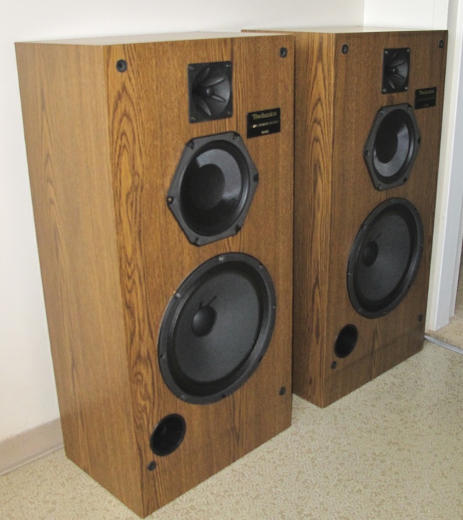

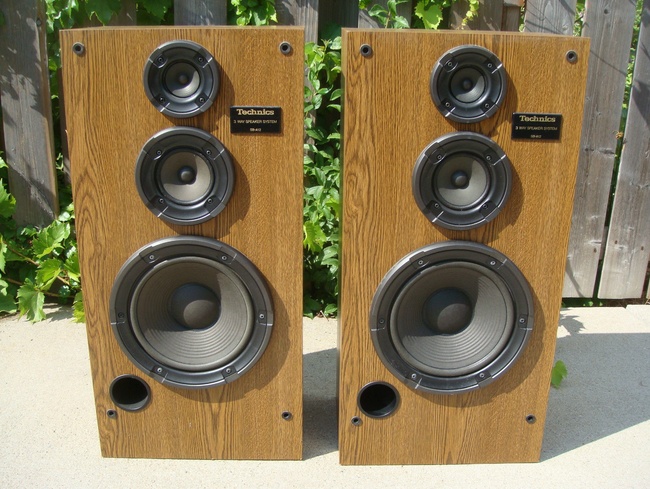

As another example, I assembled this set for my sister's bedroom. I was given this old Technics 3 way set by a mover who couldn't sell it. I've always found Technics tower speakers a bit muddy & somewhat boomy - but their build quality is very good if you overlook the faky wood veneer - there's lots of cabinet bracing and insulation as well as thick enclosure walls for minimal vibration. I swapped out the crossover and all of the drivers using Italian made Faital-Pro 10" woofers and 5 inch mid-range drivers. Not only is it highly efficient in the 95db territory as well as smooth sounding, but now it can take over 300 watts of clean power (they're much nicer to look at too). It sure is great sitting back and listening to your results in such a short time, I hated giving them up to my sister...

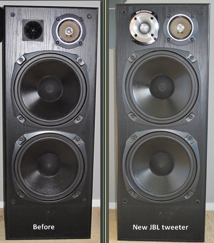

Just a quick update:
I swapped out the tweeter again (I think it's my 5th one). I was playng around with the midrange speaker but strangely enough, whatever I put in made little difference to me. It appears it was the mid highs to upper highs that were not quite there; I thought it was the midrange speaker all along. I'm finally happy with this JBL Selenium tweeter. It grabs those really fine spatial highs (echos & such) that can be elusive for some tweeters and also handles the mid highs in a smoother fashion than the other 4 I've thrown in there.
As for the switch to acoustic suspension/sealed or whatever it is I've created, it seems to be going along very well without issue. I managed to blast it for the first time this morning w/ the new JBL tweeter; the volume on each component was consistent with each other - no surprises. Bass held out great too with no boominess now that there's an extra 12" woofer in each enclosure rather than the passive rad. I was concerned about amp overload but no clipping on the amp either, so it looks as if the impedance worked out too. I find now I need to concentrate less on the mids as this tweeter has cleaned up that part of the sound image that was lacking.
I've been using a standard reference set of 28 songs encompassing 5 or 6 genres (rock/electronica/house/classical/soundtrack/jazz) to tune these speakers. It's been a bit of a journey with multiple driver swaps, but it's all been worth it. They seem to have achieved the sound that I won't tire of.
I'll bring back those audio snobs for another review in the coming weeks, but I don't need them to know that this is working out.

I hope you realize that when you added that second woofer you lowered the crossover point of the woofers by a factor of 2, leaving a gap between the woofers and mid.
