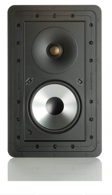

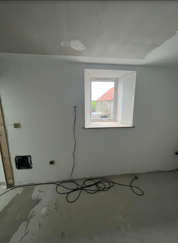

Before anyone suggests divorce, I can actually see her point - the challenge lies in the placement of the side surround speakers. Currently, the cable for this speaker exits the wall uncomfortably close to a tall, vertical window. The design of the speaker I initially chose, the CP-WT260, is quite similar to the window's orientation (tall and rectangular). This proximity creates a bit of an aesthetic clash.
Here are the specs for the CP-WT260, to give you a sense of what I was initially working with:
Frequency Response: 65 Hz – 25 kHz
Power Handling (RMS): 65 W
2-Way: 6" C-CAM cone bass driver & 1" C-CAM pivoting Gold Dome tweeter
Overall Dimensions (H x W x D): 415 x 262.5 mm
Mounting Depth: 96 mm
Weight: 3.31 kg
Construction Material: Mineral Filled ABS Plastic
Given this, I'm looking for alternatives that:
* Offer a comparable sound profile to the CP-WT260, although I'm obviously willing to compromise on this (Could be worse, it could be front LCRs....)
* Have a design that would either blend better with the proximity to the window, or could be placed in a slightly different location without compromising the sound field too much
* Budget is somewhat flexible but would appreciate some options from a range of price tiers. Interested to know if anyone has faced a similar issue or has recommendations based on these constraints - for example, maybe there's some compact on-wall speakers, or ones with a grille that can be customised to make them almost invisible? (just throwing out ideas here)

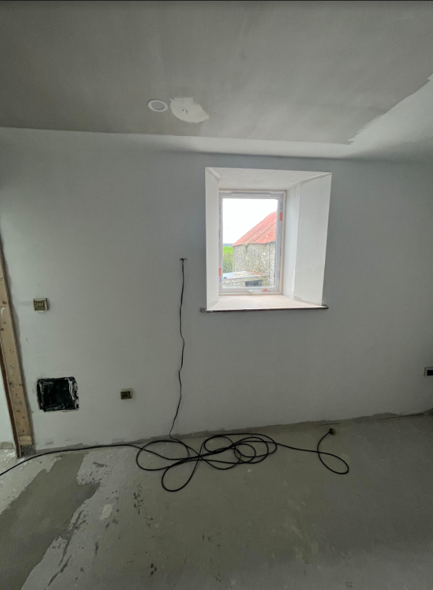

View attachment 63722View attachment 63723

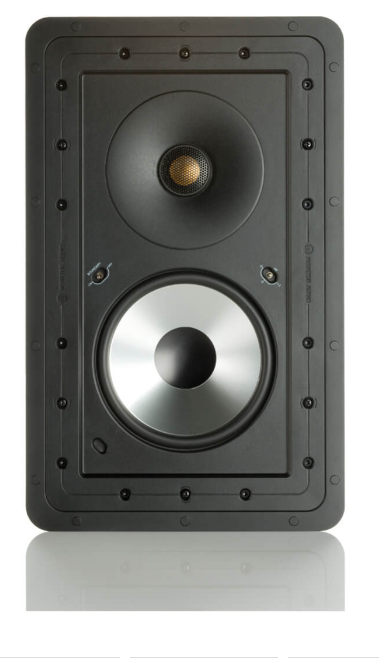

Weight: 3.31 kg
Feedback and help is much appreciated, many thanks as always
It will look bad that close to the window.
Move it to the left, it won't matter, especially if you can move the speaker opposite that one.

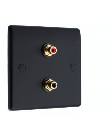

What if, instead of fixed in-wall side surrounds, I used wall plates with speaker binding posts at the initially intended positions? So when we want to use the full 7.4.4 setup, I could bring in a pair of portable stand-mounted side surround speakers. And when they're not in use, the speakers could be stored away.
It's a balance between maintaining the 7.4.4 soundstage and getting the aesthetics right. What do you guys think? Any potential pitfalls or recommendations on portable side surrounds that would work well for this? I think the terminal would look something like the picture below. It would be at about shoulder height on the wall, but would be much less conspicuous than the in-wall speaker.

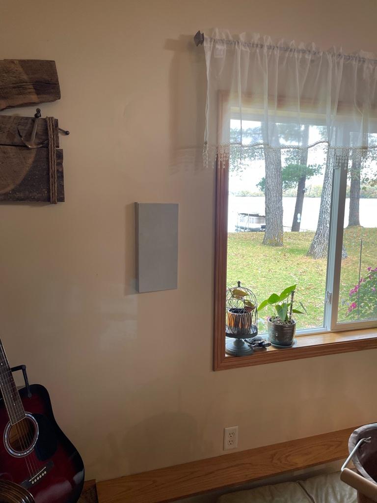

Here’s an example of what it might look like in your room. My compromise for going from 7.3 to 7.3.4 in our living room was in wall side surrounds. The other part was, NO, it won’t go anywhere else. I pay the mortgage too lol. Right side surround is mounted in a 12’ tall pillar that I purpose built for housing a speaker, and the light switches for the kitchen and LR. Everyone has their limits and only you know hers. And yours for that matter.
Point was just to show what a speaker next to a window looks like. To me it’s not horrible, and I don’t even notice them, but I don’t really care either. My old sides were 40lb JBL monitors!

I am the last person to accommodate waf (as I have never been married let alone give up my audio stuff for most wives' ideas about home decor), but seems if you do use that cover for the wall plate you could decorate it perhaps to help out. I might also want to move it to a better place considering that window....

Seems you might be posting to the OP and myself. The pic I posted was my left side surround. It ain’t movin… the op still can move his. I think WAF is stupid, and if the best place for the speaker is next to a window, so be it. You know, compromises and such. Why does the husband have to bend to the wife’s will. Should be fair on both sides. If my side speakers are ugly to someone, I don’t give a Fukk. In the context of my whole house, you wouldn’t even notice.

@TheRealOC I'm with the Doc. Move them back a little. Side surrounds are typically a little behind the seating position so you won't loose anything. From what I remember from the room they should still fall within the Dolby guidelines for placement. Too close to the window will look out of place but I hope that you have paintable grills. I have in-walls in my living room and they have a fine metal mesh grill that is paintable. The new centre speaker I purchased from Paradigm, in particular, has a finer mesh and it practically disappears into the wall. The only part that stands out is the vertical edge opposite the window (the left edge in your case). The grill is thin but there is a small shadow from the one edge. If I remember later I'll try and post a photo.

I would not opt for speaker plates and speakers on stands. For one, the speaker terminal plates will look worse than a painted grill that matches the wall colour. Second, moving the speakers back and forth will get annoying rather quickly. You will get more enjoyment when the system is convenient to use.
